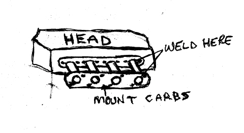

A friend of mine uses four Ninja carbs on a custom made intake for the 1000cc engine he runs in his LJ 80.

I have no pics. I can try to get some and email them to you later. I can describe the intake though, it looks easy to make provided you can weld the aluminium. At least he used aluminium for his. First a flange was made to fit the head, and round tube the same size as the carb's venturis was used for the runners. Then he made another flange which allows the carbs to bolt to the runners. Really simple actually. I posted a quick sketch here if you're not following what I'm saying.
http://jonesn.freeservers.com/images/intake.jpg

With years of experience running roundy-round cars that used motorcycle carbs, I'll warn you. One of the mojor problems is the fuel pressure. Motorcycle carb are designed to be gravity fed. The needle and seat are large, and don't take positive pressure from a pump very well.
This can be a major stumbling block when you try to get it tuned out. Flooding may become a problem, and negate any benifit to this kind of setup.

The pressurized fuel system isn't a problem...run an electric pump, into a fuel log...4 outlets to the carbs, then a return line to the gas tank. You could control the pressure at the carb by changing the restriction on the return line. Simple, cheap, effective!!
