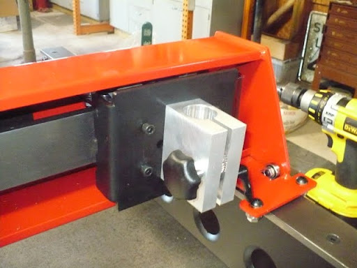

For what thermal dynamics tech center said would be the same machine, and I now have an extra SL60 hand torch (came with the cutmaster 52) to either sell, or use on my other plasma cutter that has the same torch. Another savings was the torchmate machine torch holder is $175 instead of the hand torch holder which was $275.

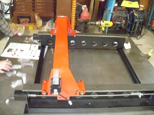

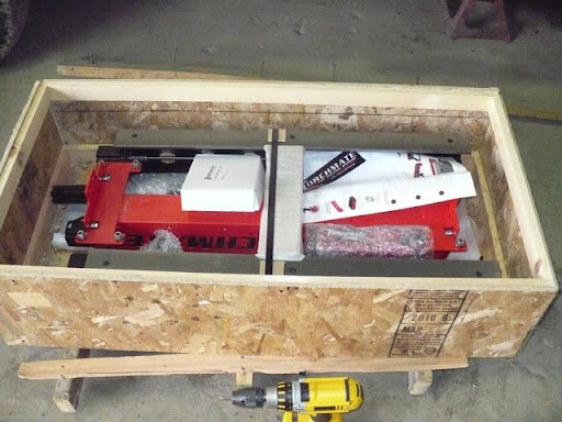

First pic is the 2x2 all boxed up.

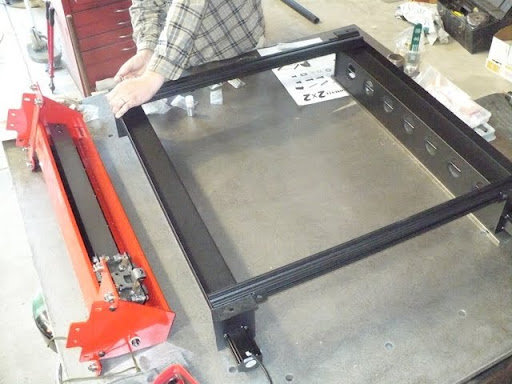

Next putting it together, which I must say was easy, and the instructions were good.
Getting it all squared up and ready to go.
Here is the machine torch holder.

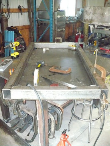

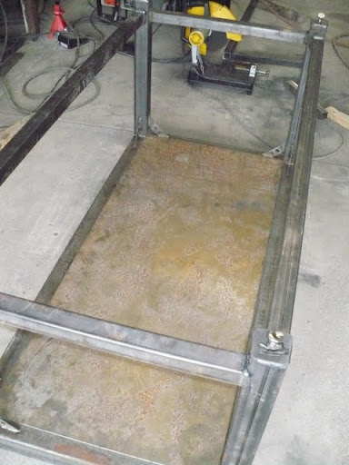

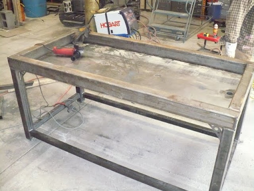

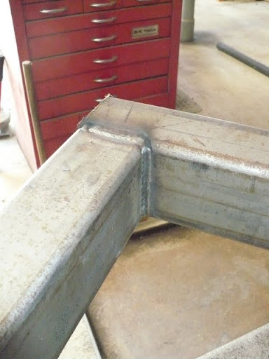

Now for the pic's on the water table, going off of some of the builds on here I decided to go with 3x4x3/16 rec. tubing for the main top.

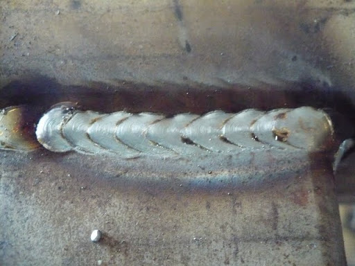

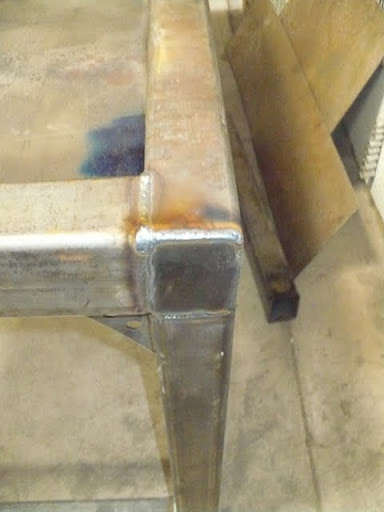

Here are some pic's of the welds.

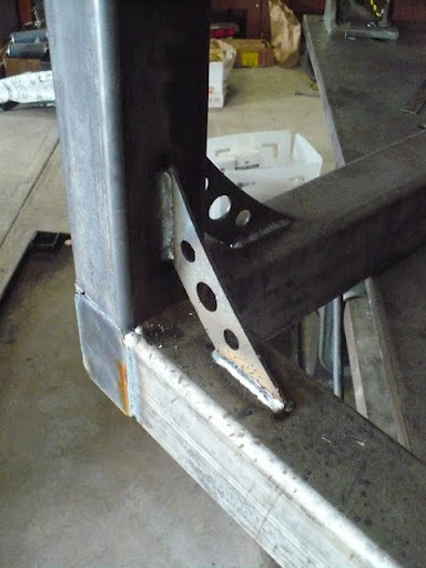

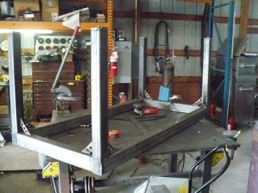

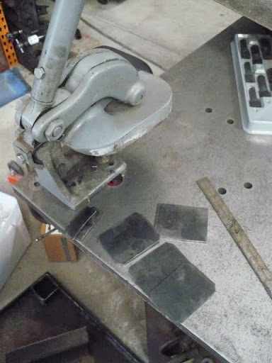

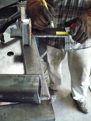

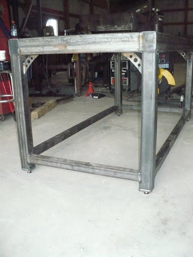

Making some caps to close off the 3x4 tubing, and have to show off my beverly shear that will cut up to 3/16 mild steel. The caps are 1/8" , also here are some pic's of the legs which are 3x3x1/4 sq. tubing, and the 3/8" plate we tapped and put leveling pads on. And here are the legs welded on and I added some gussets to add some style.
I will post up some more here in a bit to break it up alittle.
Thanks for looking Andrew

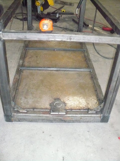

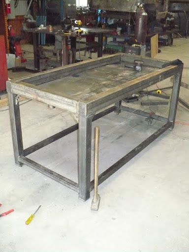

Here are some more pics of the gussets, and welds.
I also added to 2x2x1/8 tubing to the bottom of the legs to put a shelf on the bottom, to hold parts, plasma cutter, and misc stuff.

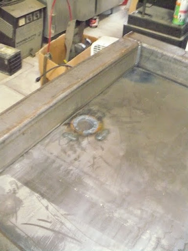

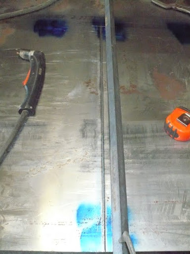

Here I took a pic after we got done cutting some 16ga. steel to put on the bottom to seal it off. We were making fun in the shop after cutting this saying who needs a cnc cutter with cuts like this. But actually the cut is like this from the info I got off this forum as I use to always just use the old plasma cutter turned all the way up with 60 amp tips, and man it made a huge difference using the lowest setting and a 20 amp tip.

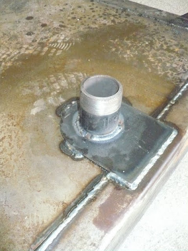

Here we are done welding in the 16ga. And now we are adding in a few support ribs, and a support for the valve, for filling and draining the water off.
And here are the last pics I got for this weekend.
Let me know what you think, and thanks for looking. Andrew

Very nice.. You don't realize how much work goes into building a table until you actually do it. I like that "beverly shear". It looks like it would be really handy to have..

Yeah the beverly shear really comes in handy, and most the stuff I have cut with it has been 1/8" thick tabs, brackets, and gussets. And it is so much quicker than a grinder, sander, or cutting disc, and is alot less clean up then plasma cutting by hand, but now that I have the torchmate the shear will probably be used less and less.
All the work we have done so far has been in the last two saturdays, about 8-10hrs. total. I am trying to take more pictures of projects going on in the shop, so I will try and keep this updated, but my brother is getting married this next weekend several states away so it will be a few weeks before I have another update.
Thanks again for looking. Andrew
