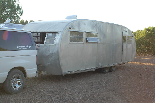

long story short; this is the bumper pull toyhauler project that i started after abandoning my (too big for what i really needed ) Airstream 5th wheel toyhauler.
due to my love for vintage "aircraft style" (riveted) aluminum trailers i`m always prowling Craigslist for potential projects.
so when i spotted this add here locally ...
old aluminum storage traveltrailer. 28 foot body. good hitch and axles. clear title. $500 firm... or it will go to the scrapyard
... i quickly grabbed my "old trailer recovery tools" and drove over there.
to my delight the "storage" trailer turned out to be a classic 1950 "Spartanette Tandem" !!!
the trailers build by Spartan Aircraft Corp in Tulsa OK are considered to be the "top of the line" trailers of that time
the `50 model was still a pure all aluminum construction (to cut cost some of the later models had less desirable wood & steel underconstruction)
sadly the 62 year old girl has seen its share of abuse and the (very valuable) original Birchwood interior/furniture as well as all the vintage appliances have already been removed and scraped
but on the drive home i instantly loved the way she was towing;
very lightweight and aerodynamic (she is basically a teardrop trailer on steroid ) ... she feels (and looks) a lot smaller then the 28' x 96" she is.

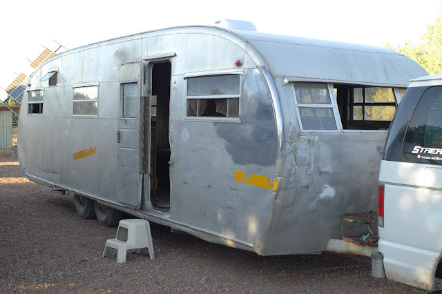

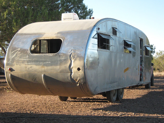

here are some pics of how (sad) she looked ;
the aluminum is oxydized dull grey , somebody drove the rear into a pole , the front had the usual jackknive damage (Spartans are known for the notorious short tongue)
as well as heavy damage to the entry door (some lowlife used a crowbar on it )
too much work/ missing parts to restore back into its original condition,
but too cool to let go to waste ...
so with the help of some "liquid inspiration" ...
...i started to see a mental picture for a potential re-use of that old lady.
more about that in my next post

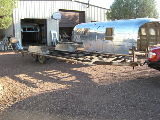

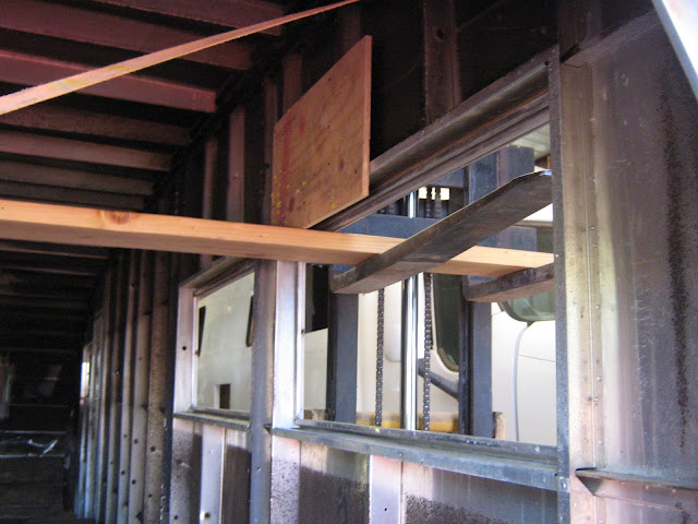

thank you .... yeah, that damn aluminum must be some highly addictive poison

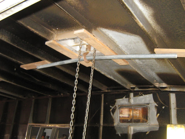

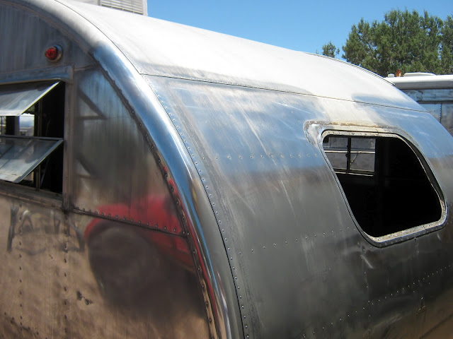

the first order of business was to remove everything possible (trim, windows, doors,... and most important; the fugly plastic Maxair vent covers);
note the high rivet count (the close spacing of the rivets) ... this is one of the things that makes the Spartan construction so superior
(compared to the lower quality Airstream )
... but the disadvantage is that if something needs to be replaced you have to drill out a gazillion rivets
as i progressed i also started to use rubbing compound to remove some of the oxidation so that i could see what needed fixing.

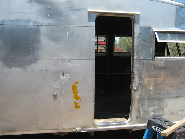

this is the crowbar damaged door opening ... i started to outline the cut for the larger (ATV compatible) double door opening ...
(note that my first line was ~50" wide. i changed later to 56" to get rid of the damage to the left of the line)

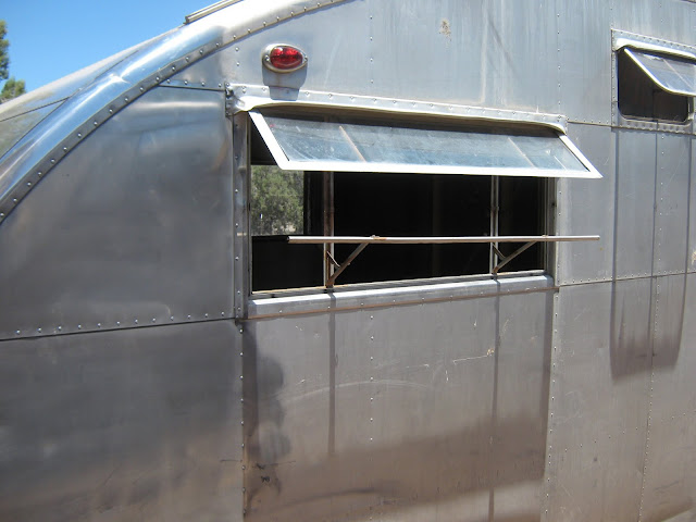

3 of the 4 original vintage teardrop lights (and one taillight) are in perfect shape.
however, my project is not a authentic restoration/ reconstruction (and i`m going to switch to all LED lights anyway)
so i will put them (and all the other leftover parts) on e-bay or the Spartan mailing list to may help out another guy who is in need of original parts.

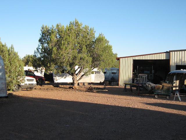

the Spartanette next to the mighty 1954 Spartan Mansion (another project )
(note that they are actually the exact same size... its the teardrop shape that makes the Spartanette look smaller then what she really is)
the front skin and all the formed support parts under it have been dented beyond repair ... so i was forced to removed everything.
btw the Manson has the same problem; badly dented frontend from careless peeps and that retarded short tongue

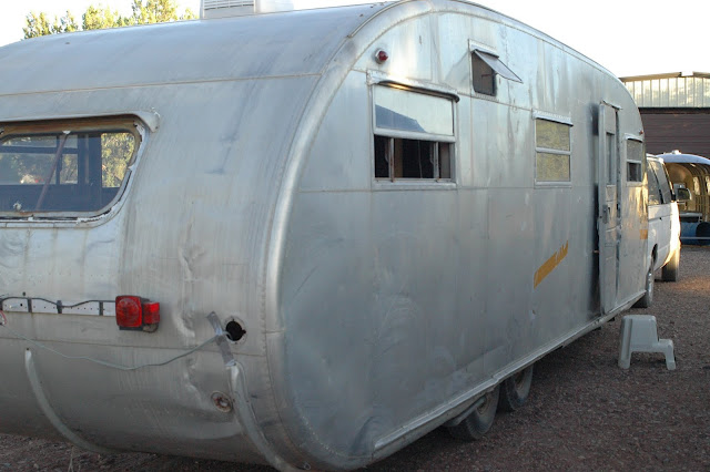

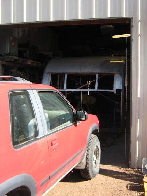

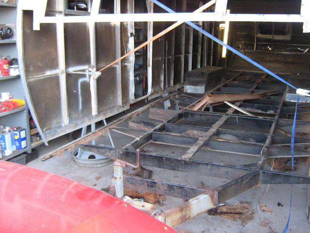

this pic shows the "pole" damage to the rear and underside ...
all the skin is aircraft quality 2420 AlClad; unlike softer aluminum it can not be straightened if it is badly crumbled like that
... so i need to drill out another gazillion rivets to replace it.
the upside of removing the rear panel is that i can also correct a couple things that i dont like;
imho the rear window is set too low (it does not match the line of the other windows) and makes the ass look droopy and heavy ...
the rollpan is also hanging lower than it needs to be.
so i decided to bite the bullet and give the old girl some cosmetic surgery
(its just another gazillion rivets to remove )

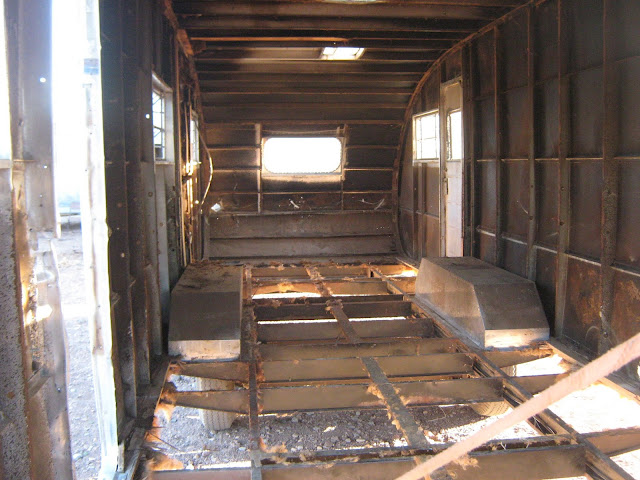

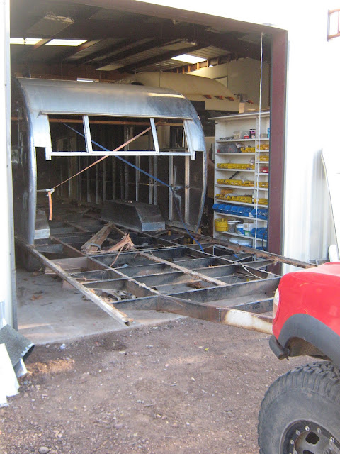

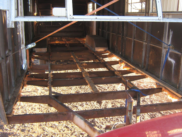

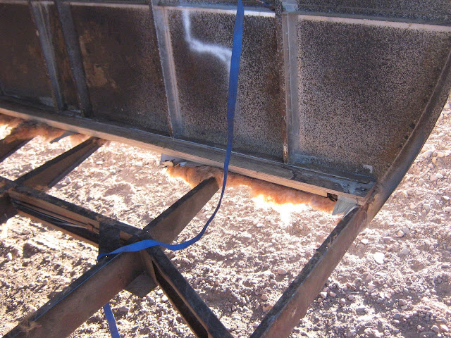

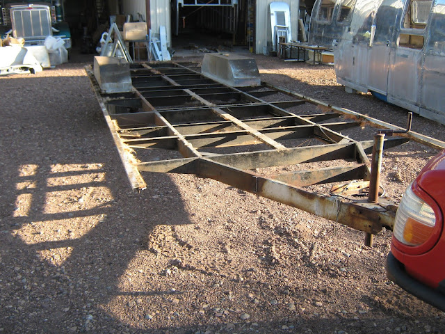

next on the list was removing the complete floor...
Spartans have the reputation to be well insulated ... i found proof of that in the floor construction;
to avoid thermal bridging of the cold steel frame the 3/4" marine quality plywood floor was actually sitting on a sub-construction of 1x4" wood strips.
except of some water damage (kitchen, entry and under the leaky rear window) the floor was in surprising good shape
... almost a shame to remove it...
but the floor needs to go to fix another design flaw common to the trailers of that time;
the side walls are actually sitting on top of (and fastened to) the wood floor.
if there is a leak somewhere in the roof/wall (or heavy condensation) the wood will eventually rot away and the trailer can looses its integrity.
so my solution is to lift the complete body off the frame and then after removal of the wood set it back down direct onto the frame.
i did the same "trick" on my Streamline trailer; there i actually added a 1.5" square tubing to the frame perimeter to compensate for the lost height of the removed wood.
but with the (imho a little taller then needed) Spartanette i decided to set the body direct onto the frame (what obviously will lower its overall height by 1.5")
later i will add aluminum L- flashing around the wall (to "cap off" and support the floor)
this way the wood floor is in between the walls and is not affected by a eventual condensation or leak in the wall.

here is another pic of the gutted interior
with the floor out of the way i discovered that the frame outriggers dont really match up with the wall supports.
(there is a 1.5" angle connecting the outriggers on the outside ... but still, having the outriggers right under or at least close to the wall supports would make more sense)
i also noticed that the leaf hangers are only bolted to the frame.
so a trick solution for the short tongue problem dawned on me;
if i slide the complete frame forward by ~10 inches (and then move the spring hangers back 10" to the original axle location)
i end up with better matching outrigger alignment as well as a long tongue without cutting/welding in the critical tongue area of the original frame.
extending the back end of the frame (under the rear bed where there is little stress on it) is a lot simpler.
so with all "body to frame" connections cut it was time to move the trailer into the shop and rig the body for liftoff

the body is extremely lightweight;
all i needed to lift it was a 2x8 across the front windows
(with a piece of plywood to protect the window profile and to spread the punctual load)...
..and a chainfall from the main shop beam down into one of the vents
(the steel rod is actually pre-bend to spread the load into the curved roof )
after a careful safety inspection my supervisor "Ozzy" (aka "chewbacca" ) is giving the "ok" ...
... and "up!" she goes

however, with the lowered body i could not "tuck" the underpan up all the way; the ass would have looked kinda pointed ... so in the end i had to extend the frame by ~ 5"
here are the pics of the frame "rollout"

i`m cheap () so i did the "angle grinder/wire brush & paint" thing around the outside ... i will repaint the rest of the frame when the body is back on and i`m finished with the changes for the holding tanks.
lol... i`m actually cheating ; the pics are not in a "real time" sequence (i`m a little ahead ).
believe me, i`m glad the worst part of removing/cleaning everything out is over ... what a ugly, dirty mess ...
