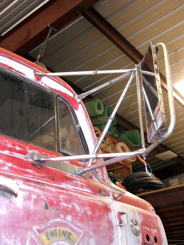

Originally Posted by lojim View Post
.... More pics please!!!
thank you for the compliment
i just made a couple more pics:
was still not completely happy with the mirror arm ...
the simple slant cut lower tubing arm was just not looking right (besides that it probably would fill up with water) and there was still too much up`n`down give in the lower arm...
so i redid it again
i added another link;
the upper and lower extension pivot point are now connected with a all-thread inside a aluminum tube
i also replaced the slant cut with a press-fit tubing endpiece and milled a angled wiring hole into the bottom of the tube...
now i`m happy with it; the complete arm is solid as a rock !

What kind of clearance lights are you going to run? I'd think some off of a 60's/70's Loadstar would look pretty bitchin on it.
i dont know yet
... i guess first i will need to build the windshield visor so i can get a idea of what will fit
the sleeper will have flush LED dots around the roofline (iirc 1.25" diameter)

i got a couple more pics;
the bed will need a headache rack so that nothing bangs into the sleeper ...
so i figured i may add something to the steel construction that fits the <T> theme.
so i cut and welded some 1" tubing into a diamond...
and then draw the signature "T" onto a piece of 3/16" plate and cut it out on the bandsaw
i rigged my little mill to high speed and used a small airgrinder stone to knock down the rough edges ...
and welded the T into the <> ...
should look good painted black in front of the polished aluminum backwall
however , i still have no clue how to do the rest of the rack ...
its kinda too modern but i really would like to integrate a strip of E-track into it ...
