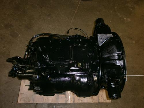

found a RTO9513 as well as a RTO12613 for $950 ... the only thing that sucks is the $500 core charge (and i bet they are not willing to take the 5-speed as a core )
thats why i have to check with local yards... they may be a little more flexible with trading and things (i do have a shitload of semi stuff to get rid off, so i may be able to work out a deal)
