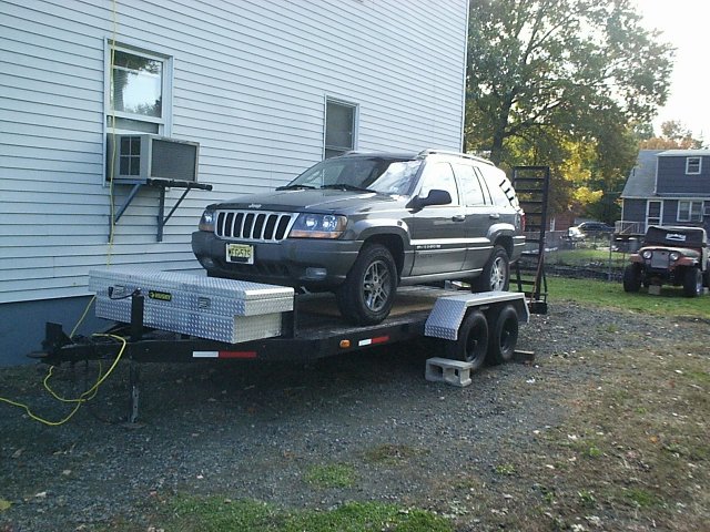

Right now I have a skid steer trailer with ramps that stick way up in the air:
I'd like to hack these things off and make a little storage area under the deck for them but I'm unsure about how to attach them when they'll be in use, and how to lock them in when they're in transit.
Right now, these swing on what looks like a 1.25" solid steel roundstock that goes across the entire back. I'm open to leaving that in place and hooking the ramps onto there, or changing around the rear most c-chanell bar to accomodate some sort of tie in mechanism. I do not think I *need* to have them slide out right from the rear, but ideally, I think I'd like them to slide out, then I can pick them up and drop them onto something at the deck level where they'd stay attached.
Any pics or ideas would be great, pics would be preferred because I don't read so gud.
Thanks in advance,
Bryan

My trailer has some small diameter round rod hung off the rear C-channel of the deck by an inch or so. Goes from the edge of the deck inboard two feet or three.. something like that, with a space in the middle where there isn't a round-rod.
The Ramps have a hook on one end - nothing more high tech than a piece of angle welded to the end to take a "plain" ramp and add a "C"/U shaped "hook" on the end.
This area drops down onto the rod.. ta-da.
I've been thinking of adding some under-deck ramp storage.
Thinkin' of something as simple as two (or four - two per ramp) hunks of angle welded under the deck like "L" to slide the ramps into.
I'd go side-to-side, I think.
You could also go fore/aft, just make sure you move 'em far enough forward from the end of the deck that you don't hurt your departure angle (laugh, but departure angle on your trailer can be important!).
Weld "tabs" on the "under/forward" end to keep the ramps from going too far forward.
Then use a hitch-pin in the very center to lock the ramps from falling out.
Or, use a pin THROUGH the ramp and the end of the "slides" to lock the ramps in place.. won't even bounce and clang as much that way.
-Tom

What I don't is as follows:
  • the trailer is barely long enough to accomodate a WJ:
    And even though I only have a CJ7 to go on there (more regularly), I like the idea of having room for something larger. IE, FS pickup.
  • The ramps sway like a couple of drunks when I'm motoring down the road.
  • They're also very tall, giving the trailer a larger appearance when being stowed, which just isn't as aesthetically pleasing
  • The ramps are eating into that solid rod across the back, eventually I'd have to do something with them.
  • I'd like to be able to open that up so if I'm having something loaded by fork truck, they can dump two skids on the back there, or whatever. As it is, they can load a skid in front of the fenders, but that's it.
Bryan

The only thing I don't want with the side to side mount is having to make a nice HD ramp and then carry it around to the side to put it away. I think if you can just mount it fore/aft you can just pick up the rod end, drop it into the slided, then pick up the other end and push...covering your ears because it'll cause quite a racket!
I agree with your mounting ideas, that would retain the flexibility I want for different width vehicles, also help with angularity/different mounting surfaces.

My gooseneck was built by a friend. He made a support frame under the bed from angle iron to slide the ramps into from the rear. There is a door for each ramp. He did a nice job of it. I can send you some pics if you want.

Some I beam in the center, two pieces of angle down the side, drill a hole in the end of the Ibeam for one of those bling bling "climbers hooks" rated for 150lbs... the ones you see everywhere. run that through the hole to hold the ramps in. Thats what I am doing someday... moving my 80lb ramps from the deck to the back sucks!

This setup is nice because all you have to do is open the door, slide the ramps out and set the ends on the lip of the trailer. No carrying them or tying them down. They're always out of the way, and the door could be locked. I just use a pin normally.
Looks like you could shorten those ramps to 2/3 or 1/2 the length they are in the pic.
