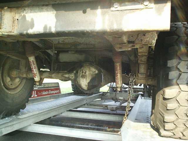

Check to see if there's a Hertz Equipment Rental near you. Me and a buddy rented two trailers from them for $175/week each.
Left one is the 6 ton model, 104" deck, 20 foot bed.
Right one (mine) is the 5 ton model, 80" between fenders, 16 foot bed. Fenders are strong enough to drive over if necessary.
The 6 ton had electric brakes which is why he had that trailer, 5 ton had surge brakes. Both uses pintle hitches.
Middle one is a rental too but from some other place. $55/day I think it was.

The surge brakes work, and work easily, the trailer is a little noisy over bumps, but all in all it's a good deal for $50/day. I've since bought my own, but when I didn't have the dinero, etc...
EDIT: FW axles will probably not fit.
These are stock with 38s:
