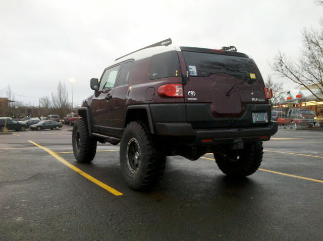

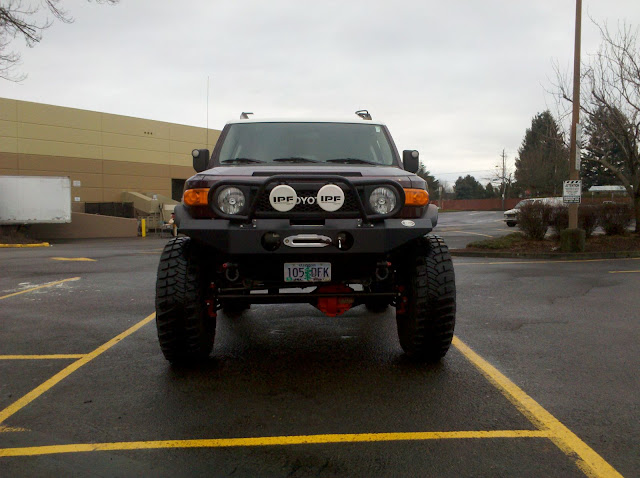

Member # 149313
Posts: 20
2007 FJC 28,000 miles
Stock Engine
Auto Tranny
Stock transfer case
Rack removed so I can fit in the garage
Front
Dana 44 high pinion 4.88 gears and ARB locker
Fox 2.5" x 12" travel remote reservoir shocks
3 link w/ panhard
Marlin crawler IFS steering box tapped for hydro assist
Rear
stock axle 4.88 gears
FJ 80 front springs + 5" or so over stock
Fox shocks
Wheels- some fake beadlocks can't remember the model
tires- Goodyear MTR kevlar 37- 12.5 -17
Still a work in progress but I have been pounding the pavement.
Need a front driveline then some wheeling pics
Larry
