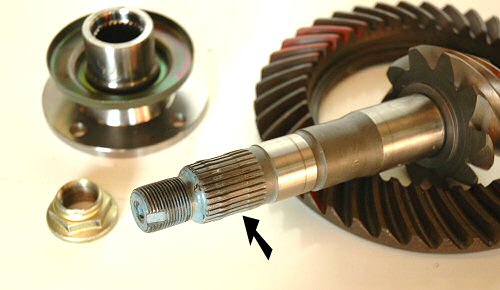

The rules state 4.10 gears must be used. We just happen to have a couple of factory new R&P gear sets that were removed from electric locked diffs sitting on the shelf. The front set came out of an 8" FJ80 and is reverse cut. The rear set came out of a new TRD 8" rear Tacoma diff. The interesting thing about these electric style gears is they use a larger 30 spline shaft and flange. Normal 8" gears use a smaller 27 spline shaft and flange. This is not a major failure point but is an interesting difference. FYI if you use these electric gears in a non electric housing, make sure to use the matching electric style flange!
Here is a close up of the spline...
Chris Geiger is offline   Reply With Quote Quick reply to this message

Hey Chris.. so if this is the case... I use to have a Tacoma with w. E-locker (stock 4.10s as you stated) and went to 4.88s, how come it didnt need the a older flange? or visa-virsa..I still have these "30" spindle gears..so they wouldnt just fit into and run in an older 8" housing??
If you order 4.88 or 5.29 gears for a Tacoma rear 8" diff, the gear set should have the larger pinion, thus it will fit your existing, larger electric style flange.
The "extra" 4.10 gears you have will fit the older style housings. That's exactly what we are doing. We are installing the later electric gears in to non electric housings. I prefer Detroits but for this application we will be using ARB's. I believe the ARB's will give the best ability to turn.
I like the electric lockers I have front and rear on my FJ80 but the ARB's lock and unlock faster than the electrics do.

what if I want to replace my older (85' 4.10s) with the newer 4.10s???
Just use the larger electric style flange and the gears will work fine.
