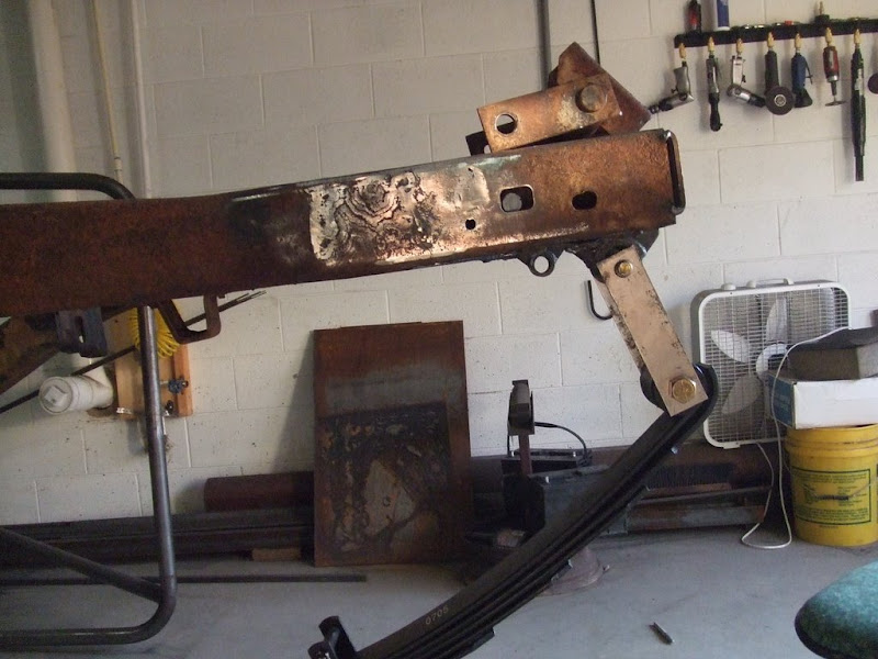

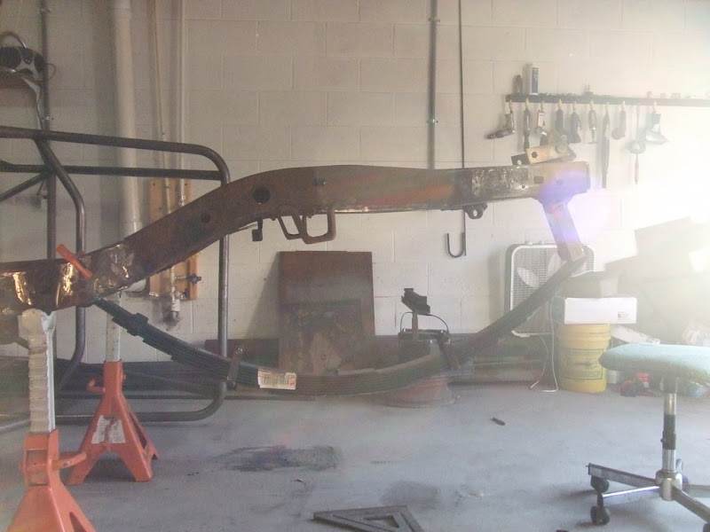

With the springs hanging and no weight at all what should ones rear shackle angle look like? straight down or similar to what I have here? I'm mocking this in and would appreciate the advice.

go by the measurements chris gave you if they are TG 5" springs.
either way, i doubt that is a good. are those new springs? if so, they are going to settle.
with the spring hanging with no weight, i would want the shackle angle about negative 10 degrees more or less. with wieght on the new springs, about 10 degrees or so, because the springs will settle and you might take leaves out like i do and then the shackle angle increases to a desired 30 to 45 degrees.

Are you sure about that 55.5" rear measurement? I could be wrong but I talked to Matt last week about that same measurement and I'm pretty sure he said 52.5". I just bought a set of 5" lift TG springs and modified them just like you said. Bottom two leafs removed from the fronts and the 1st and third removed from the rears. This is how it sets with 5" shackles. Center to center is 52.5". I'll be putting on 6" shackles tomorrow and wheeling it Saturday so I'll let you know how it comes out.

AZyota, your shackle looks way to angled right now in my opinion. 3 more inches back on the back of the frame would fix it nicely, especially if those springs are still brand new.

Yeah, I agree its too angled with the 5" shackle. I just listened to the message Matt left on my phone. He said 44-3/4" up front and 52-1/4" on the rears. That was center to center on the hard mounts. Thats also for 6" shackles. I ordered 6" shackles Monday from TG and they got here yesterday. I'll put them on tomorrow and post up some new pics.
If I moved the mount 3" back that would be pretty close to vertical. I don't think that would be good at all. Vertical shackles work okay for up travel, but really limit your droop. Check out Hobies post above. He recommended 30 to 45 degrees. I'm not sure if thats from the vertical or horizontal plane.

Straighter vertical shackles tend to help with climbs. and I'm pretty sure thats what Hobie was referring to.

I moved my shackle hangers to the rear of the xmember and it put me right at 52.5". My front is 44.5". I'm thinking 6" shackles for the rear.
