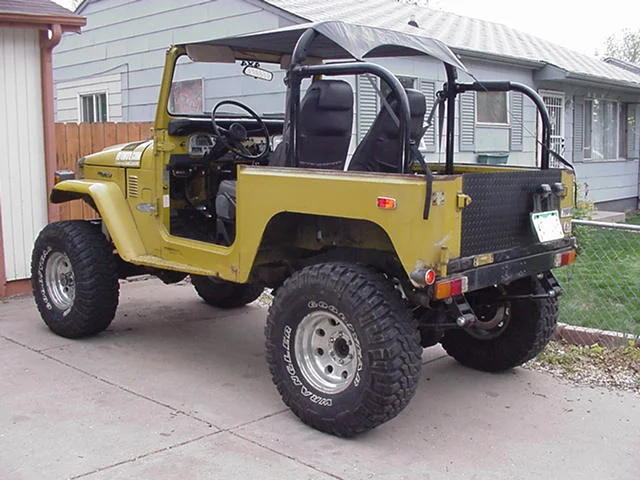

i used 5/8' bolts on mine..
I used 60 springs on the rear of my 40. Flipped them.. I ended up 5" back from Stock..
they flex good, and are easier to source than the 55's

wicked truck man are you running 37s? any pics of your hangers? you running a wrap bar? oh yeah and awesom job with the fender cut what did you use?

just saw the pics on you buildup thread! thanks for the help
