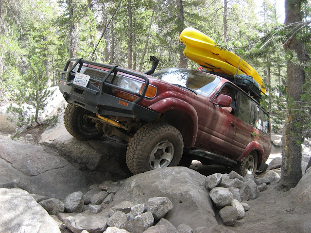

Not a doubt about it...1991/1992 FJ80. You'll have a 3fe, no factory locker option (cause you'll want ARB lockers of course anyway) and the original 80 look of the grill and dash. If you want factory lockers than 1994 is the year to go with because it has the best of everything.
The Boone
BooKilla is offline   Reply With Quote
Old 09-15-2008, 10:44 AM   #16 (permalink)
Join Date: Jan 2005
Member # 41854
Posts: 176
Other than differences in the early years of the 40s and 55s, the drivetrains on these things didn't change a lot until '91. They had the same front and rear diffs, 3.70 or 4.10 gearing (4.10 maybe in some 40s, def. once they put the 3FE in the 62), and the front axle shares birfs with the mini trucks. In 91 with the FJ80 the front axle was changed to a HP-8" with larger birfs. The t-case is a full time hi/low unit in the 80s with a viscous coupling added in '93. '93 also meant larger rotors on the front, rear discs, ABS, the option for factory e-lockers, and a FF rear axle. The 1FZ-FE is known to give headgasket issues, and pretty much the only way to prevent failure is to replace with the newer corrected head gasket.
A factory locked FZJ80 can fit 33" tires stock and will go more places than any other cruiser ever could from the factory. Lifting is easy compared to lifting other vehicles. Up to 3" just means springs, shocks, caster bushings....and means you can run 35" tires with minimal rubbing. Above that you get into driveline issues (vibrations), castor correction issues (arms/plates become necessary), and brake-lines being too short. The wheelwells are huge on these things too. I run 38.5x11 boggers, have my bumpstops extended 2", and do not rub at all in the front and barely rub in the rear. (flares and mudflaps got ripped off previously making this fitment much easier).
The 80, IMO, is the BEST cruiser made. It drives like a cadillac on and off-raod, has decent power with the 1FZ, is a very tough vehicle with a very strong drivetrain, and the interior is roomy and comfortable (unless you NEED cupholders and are taller than 6').
The deciding factors are really: interior comfort (pre FJ80 is sub-par IMO), body style, and coil vs leaf springs. Once you decide those, we can help you pick the best year of the model that has all the best components of the model.
