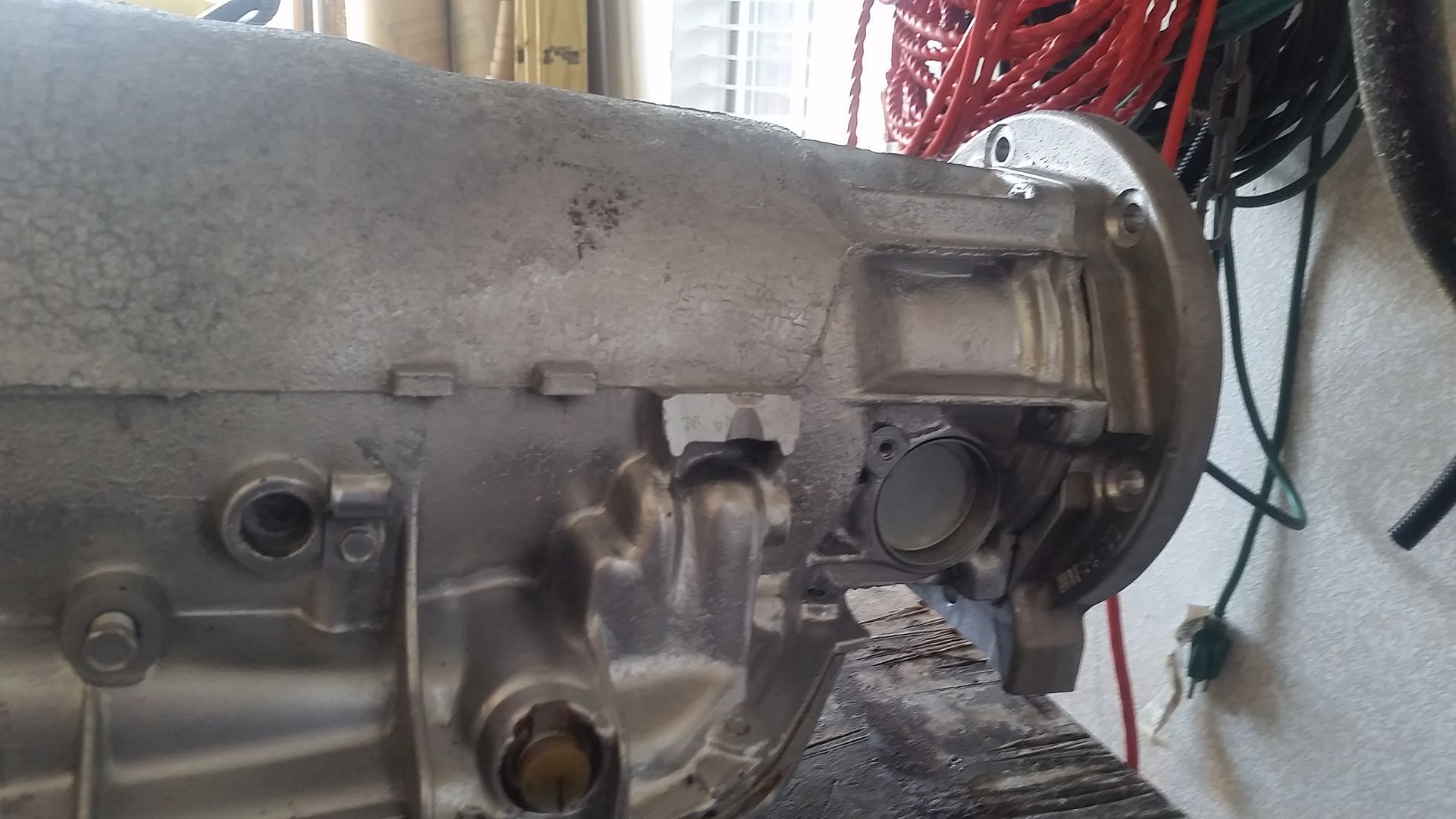

New TH400 and just slapped on a Advance adapters adapter to run the Atlas behind the TH400.
[IMG][/IMG]
