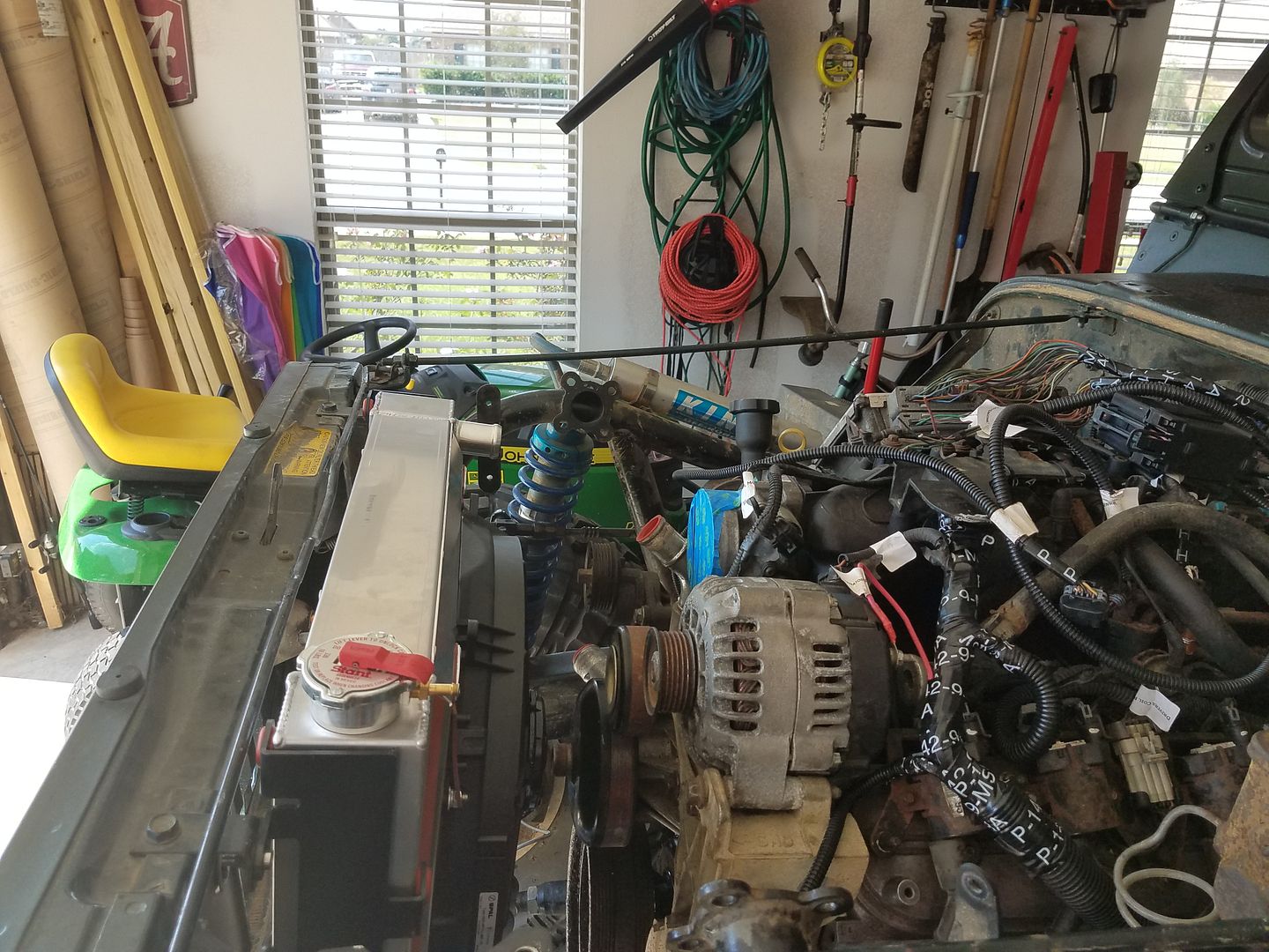

Engine and tranny fully installed. Here is a shot of the rad clearance. Shot is not a great angle but about 3/4-1.0" between water pump snout and fan motor. I can grind/file a little of the water pump snout if needed but prefer not to gank the threads if not necessary (for removal down the road).

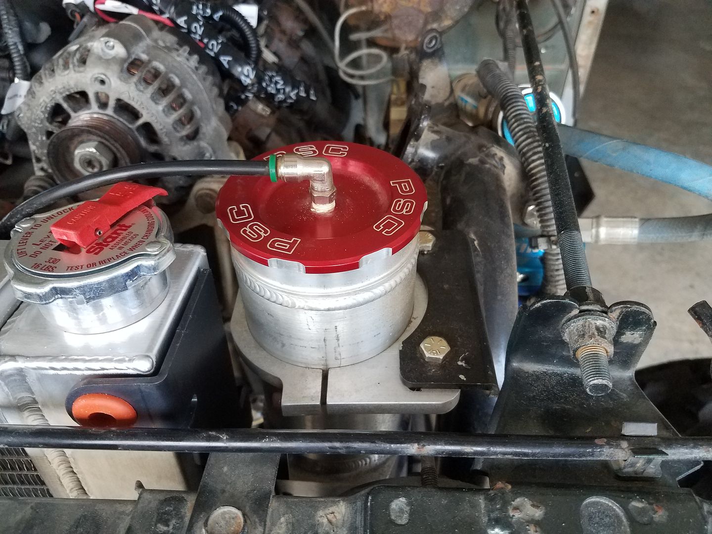

Steering reservoir in but also a little tight. May need to file a little.
[IMG][/IMG]
