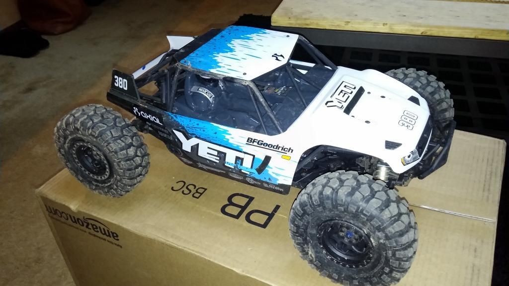

Well I bought a Yeti on a sick day from work. Its definitely entertaining. It goes 32mph thanks to a big brushless motor and hill climbs and rolls like a southern buggy.

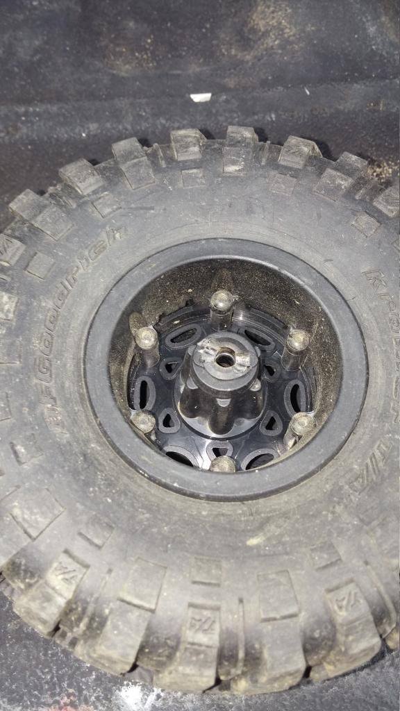

Ripped it for a while, then checked it because the front wheel drive stopped working. A set screw fell out of the front driveline. Tightened everything. An hour later one of the rears stopped spinning. Crappy plastic hub stripped. Ordered 10 of them
This is the other side that started stripping

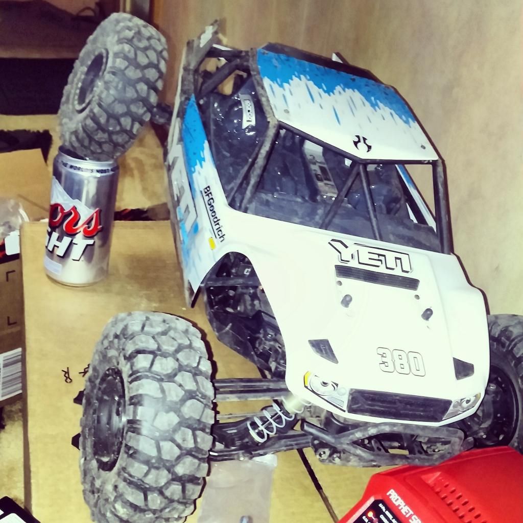

The spur gear was destroyed today after a cyclone doughnut show on pavement. New hubs are installed and steel spur gear is ordered and should be here tuesday. Also picked up another 5000mah 3s Lipo for twice the fun. 90% of the upgrade parts are backordered so I'm upgrading as I go. I lost the driveline at max speed, turns out there is a screw that holds/connects the cv to the driveline. If anyone buys a Yeti or Axial, I highly recommend taking loctite to the entire truck before you use it. Everything was loose out of the box which lead to all broken parts so far, including the slop on the spur gear.
This is the first real rc car I've had and I'm learning as I go. definitely pulls wheelies on concrete so I like it immediately.
