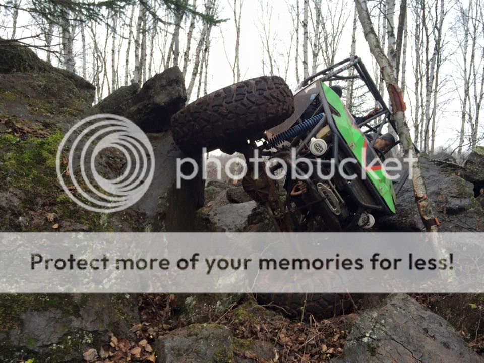

02-13-2018 05:51 AM
Blue Bomber That is awesome! Thanks for the pics! I need to figure something out to get a better crawl ratio.

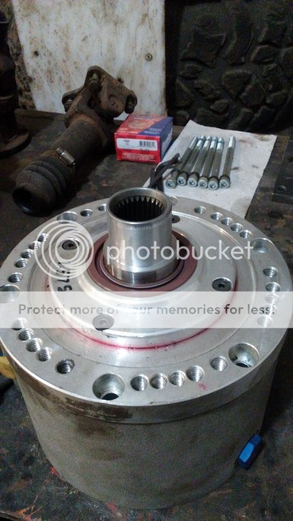

littlebuddy Attached are a few pictures of the adapter I had to make to mate the 4 speed Atlas up to the 4L30E transmission. The third pic is the input shaft on the Atlas machined down to fit the transmission. Also included a few pic's of my rig.

littlebuddy She’s in!!!
I received my 4 speed Atlas last month and have to say that she’s in my 99 Isuzu Rodeo buggy. Before starting this project, I searched the internet for any advice, but I found nothing. I did install the 3:1 gear reduction in my stock transfer case from Independent 4x4 a few years ago but I still wanted something a little lower for more control in the rocks. I knew I wanted a 4 speed Atlas but wasn’t for sure exactly what was all involved to matting it up to my 4L30E transmission. All I knew was the 4L30E transmission had a 27 spline count and that Atlas makes a female 27 spline input shaft, so I made my purchase. After receiving my Atlas, I noticed to get the same spline engagement as my current transfer case I had to machine the OD of the input shaft on the Atlas and by doing this I was also able to use the standard 4L30E seal. The next step was to make an adapter to mate up to the Atlas and the 4L30E transmission. I got lucky since I was able to use the current 4L30E adapter plus I would need a 0.75 adapter plate to get the proper spacing for everything. I still have to make driveshafts and other odds and end before the initial test run.
