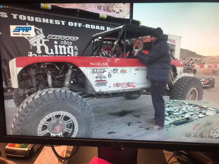

Originally Posted by jr4x View Post
I've started and deleted several replies today. I have learned a lot more about this stuff the last year. Have helped some, and let down some. I need to re-connect with the_T_man and see what we can do.
In the past I've tried to be pretty passive about "helping" because I'm not a race shop and I don't sell parts. That was until I directed a friend to talk to AGR steerco for a second opinion on steering solutions. Just last week Beverly Croy had a surgery on a shattered wrist sustained at KOH from the junk he convinced them was the solution to their problem. She hit something minor in her 4500 car pre running and it snapped her wrist because the wheels turn the steering wheel, not the other way around.
I feel terrible because I didn't have time to help them with our solution, which as long as the hydraulic system is intact cannot rip the wheel out of your hand. So I'm hesitant to help at the current time. At the same time, I did help Duane Garretson who has the very first jimmy's 4x4 4500 car. It is 4 linked with a bell crank setup and the steering box is right in front of the drivers feet. He also had one of the first PSC 4500 steering kits that didn't work and has since been pulled from their product line. With it he had the pulsation/oscillation and it was unfix able with the parts he was sold. Still following PSC's advice he removed it and went back to a regular ram assist setup and went back to breaking steering boxes every race. He got sick of that and contacted me to help him out. I built him two gear boxes myself and had him send the servo back to sweet to un PSC it. Those two changes alone fixed the tire shaking issue. Why is that? The only thing I can think is that the servo and pump we are using are meant to be a quick ratio setup. There are no quick ratio manual gearboxes that we've found (and I'm not looking for them). The typical 24:1 manual gear box is to slow and the hydraulic side must out run it in both directions causing the shaking.
Our team just built and raced a brand new 4500 car with a new Howe servo setup like we ran in the old car. Shawn drove it to 5th in class and 24th overall in it's first EMC. I drove it 70 mph in the big whoops out at Johnson valley and it is an absolute pleasure cruise to steer. There are no shaking/oscillation/pulsation issues with our recipe which takes custom box work to make possible. A quickner doesn't solve any problems, it only creates more. So in time it has turned out that one cannot re create our success and cheapen the parts list at the same time. It takes what it takes, anything less results in blown money on a tire shaker.
If you look close you can see the steering box and the servo in this pic
Hey yea didnt get to chat with you at KOH this year , we did race , did finish , did have a slight mishap with our box the cap came loose or 4 bolts Im assuming some bumpsteer , after not much luck connecting with you we tried various different configurations again , we modded some boxes like you as that was really the only difference in our steering set up to yours it didnt do the trick . but we are a bellcrank set up like Duane Garretson's car not like yours I think the ratio's are not correct in how they were originally set up . we changed the box and made it a powered box , got rid of the sweet valve and kept the rest I guess now we are just a fancy hydro assist set up lol ... it worked 500% better than last year is it correct now ? probably not were we sick of chasing ourselves in circles yes !!!! it did feel great driving it and not having that ridiculous chatter , for time being we are going to safety the cap bolts , hopefully race the rig a bit this year and when we have more time we will dive into it again ...
