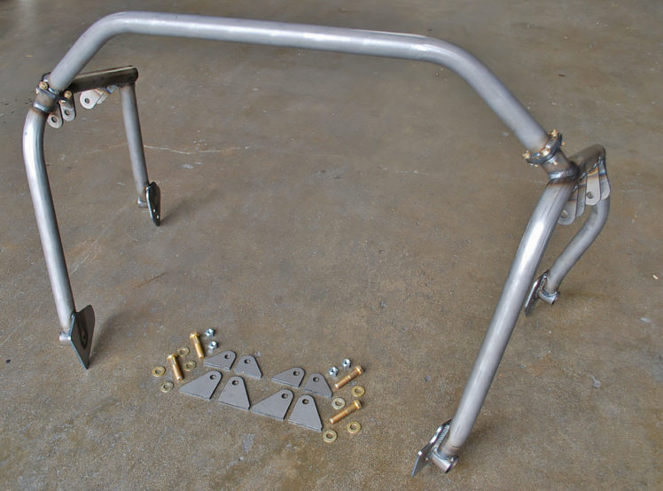

mobil1syn sounds like you need to be looking into something like this
https://desolatemotorsports.com/shop...t-coming-soon/
