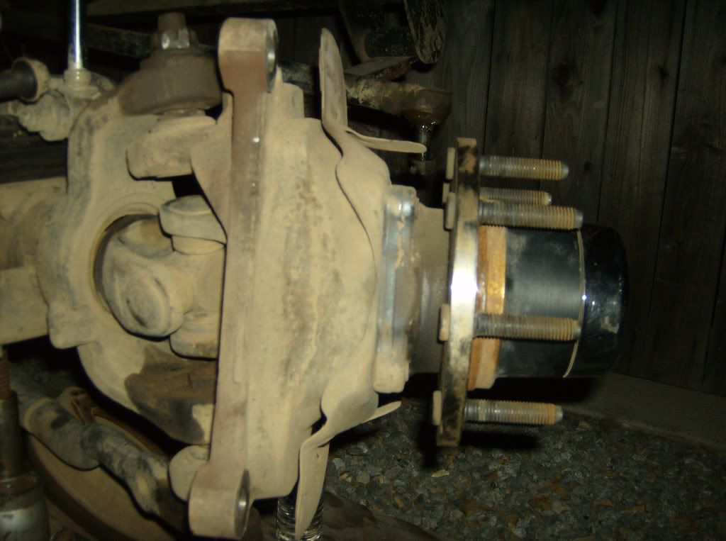

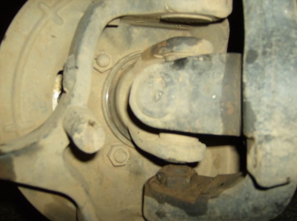

hey there I am in the middle of replacing the ball joints in my truck. I have a set of 1Ton axles out of a 99' F350 superduty I believe, and this is my first time having to do ball joints. I feel stupid asking this cause Im pretty sure I know whats goin on, but better be safe then sorry and disasemble more then I really have to. I was looking at my knuckle and seen that there isnt enough room for the upper ball joint to drop out, so I have to pull the axleshaft. My question is can I unbolt the whole hub assembely off the knuckle(4bolts)and slide it off the short shaft or do I have to disasemble the hub itself first?

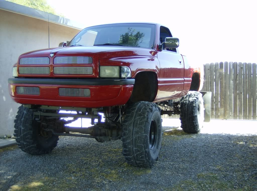

(sorry if you dont like the dodge I had to show you my truck/project)

x2 remove the unit bearing. or, you can try to disassemble it, but if you do... take pictures. :flipoff2::laughing: i think its 4 bolts.
pull the unit bearing, the shaft, then it gets easier. make sure you torque it all back to spec (including the unit bearing) when your done...
edit: do you have a press? or a ball joint installer/remover? it becomes a bitch really fast if not...

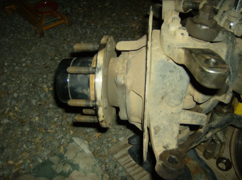

sweet thanks for the info thats what I was hoping to hear. Does anyone have any pictures of this unitbearding and is there anything I should know before unbolting the 4 nuts. I have a bubby with a press so Ill just take it over there,

and thanks for all the info guys the knuckle is off and the new ball joints are getting pressed in right now and I also got a seal kit, and will probably get bearings too. The truck is badass to drive though, and it wheels bitchin too,
