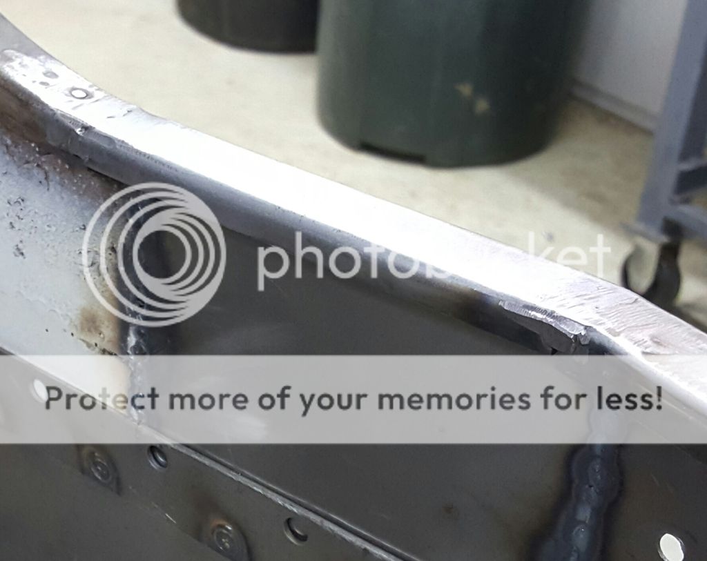

Progress! I've been doing sheetmetal work for what seems like an eternity now. Im really liking the way things are turning out. All of the panels are made from 18 gauge. I made nearly every panel with a 3/4" flange on at least one side, so that I could use screws to hold everything together before commiting to welding. Its way easier to remove a screw, than to drill out a spot weld.
I used #8 self-tapping screws to hold everything together. They do a good job of drawing the panels together if you have a small gap. I know some may say that I should have used clecos, but these have the same outcome. Either way you have a 1/8" hole through both panels that will need to be welded up. Clecos wouldve ran me about $50 for 25 clecos and the set of pliers shipped. I got 100 screws for $6 at Home Depot. Got to save some folding money for other parts.

Alright guys, the rear floor is all screwed together. Heres a pic, Im very happy with how it turned out.
As much as Ive grown to dislike sheetmetal work, here is a simple repair I wanted to share that someone might pick up and use on their rig.
I had a bad spot that needed to be repaired, so made a small wood hammerform to form the metal. Heres the hole that I needed to fill.
Heres the hammerform. Its 18g steel, sandwiched between two pieces of 3/4" MDF. I slowly started to work steel down with a deadblow, then I used a flat profile body hammer to make the edge a little more crisp. Then I continued around the bottom edge of the lower hammerform to create the "J" bend.
100 tacks later, and a little bit of grinding, and this is the result.
