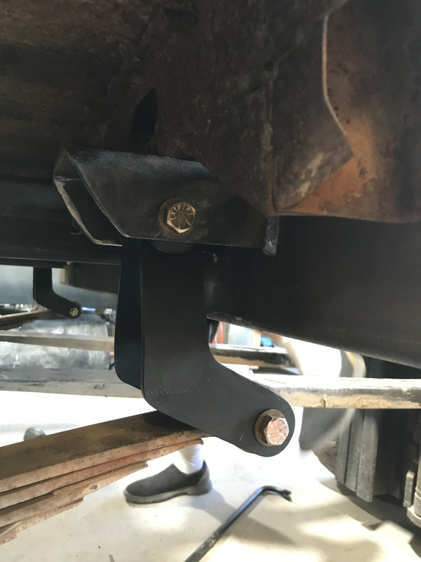

Spent a couple hrs. working on some boomer rang shackles for the rear. Made from 3/8" plate and a bushing kit.
Installed in the combo, body mount, shackle hanger. Will tie the cage to this also.
Lift holding the front up where I like it. Front needs 4-5" of lift.

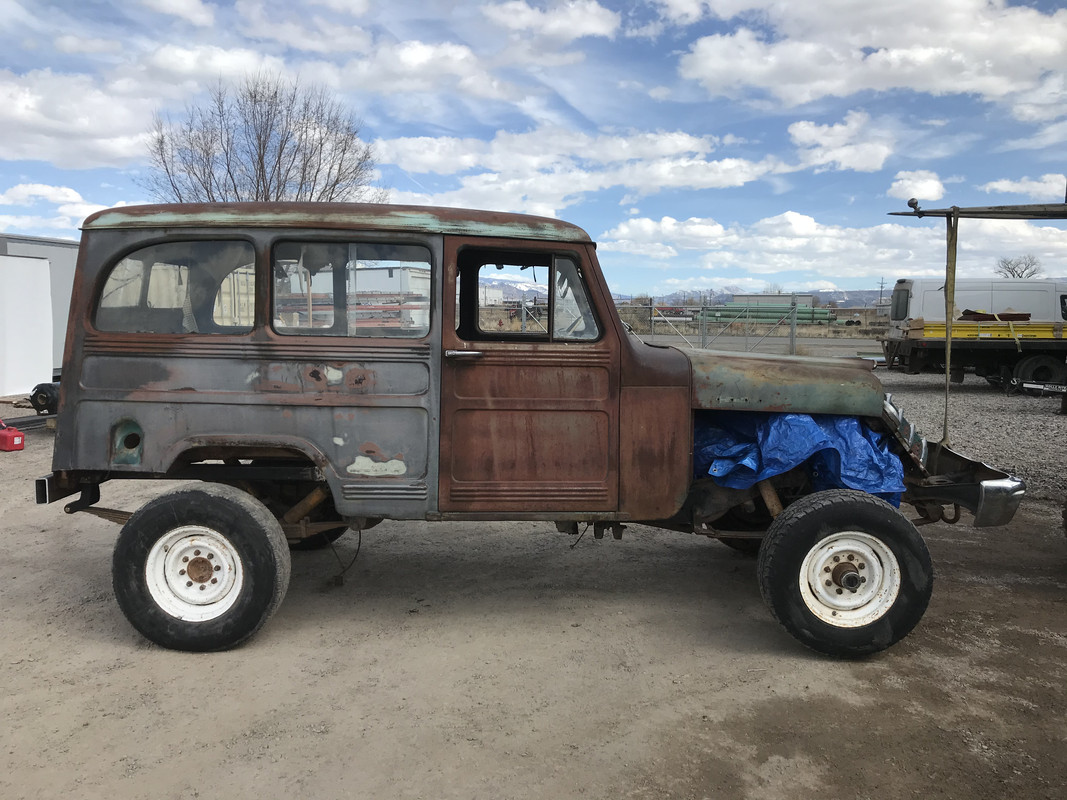

First time the front clip and body have been together in yrs. Also started on the floor body support.

This will be a mild trail rig/ DD. It did end up at about short box wheelbase.
