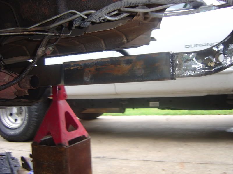

I figured that I would finally post a buildup thread. Started with a rear stretch.

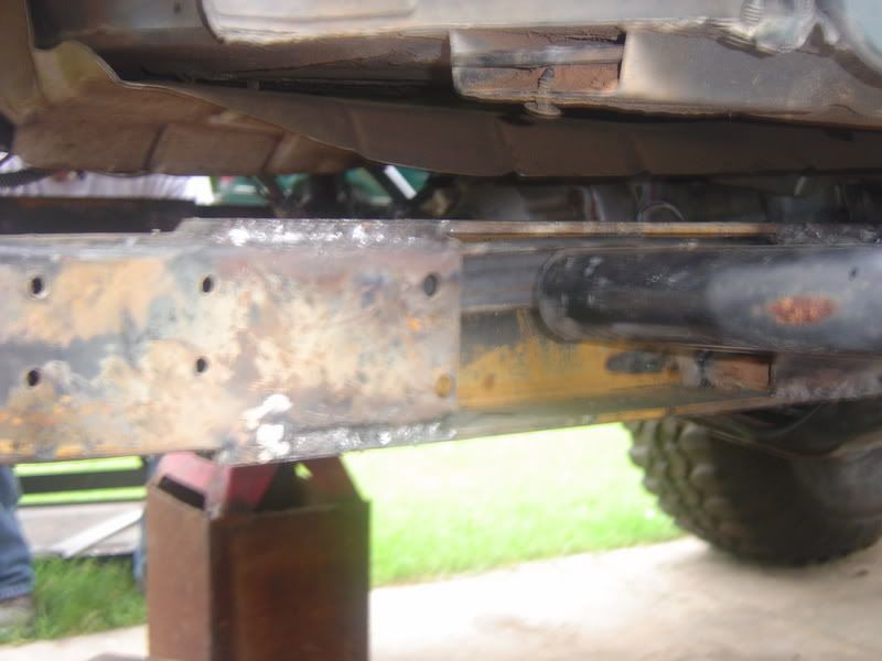

I cut the frame just behind the body mount under the doors and had a metal fabricator break me some 1/4" wall c-channel to fit over the frame snug. I braced the frame to keep it square before I went to cutting
887 Posts
Discussion Starter #2 (Edited)
This was my finished wb............not the correct ride height.
I eliminated the track bar and heres how the control arms lay
