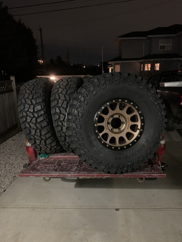

Haven't done an update in awhile, mostly because i havent really been working on it. I got busy and then i ran into issues with layout of the front suspension and steering, which really sapped my motivation. I think ive got it figured out now and it seems like its gonna work as i had originally planned.

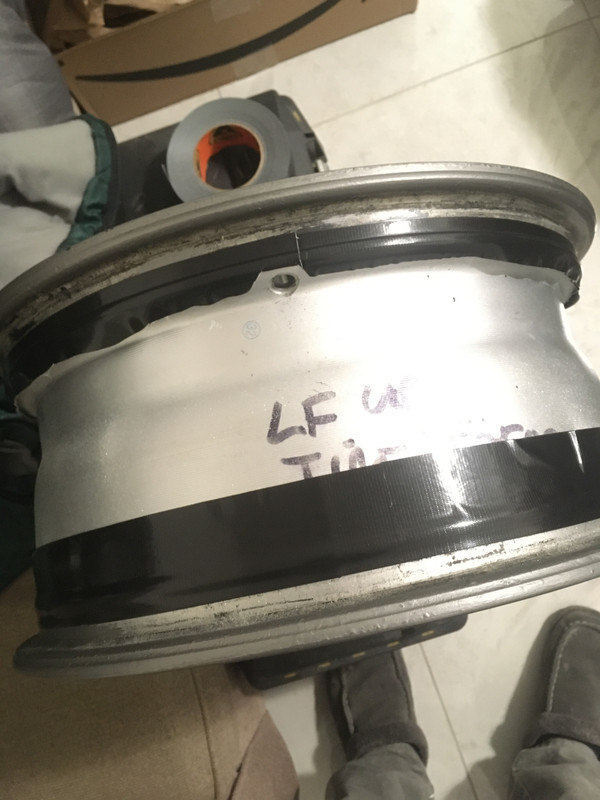

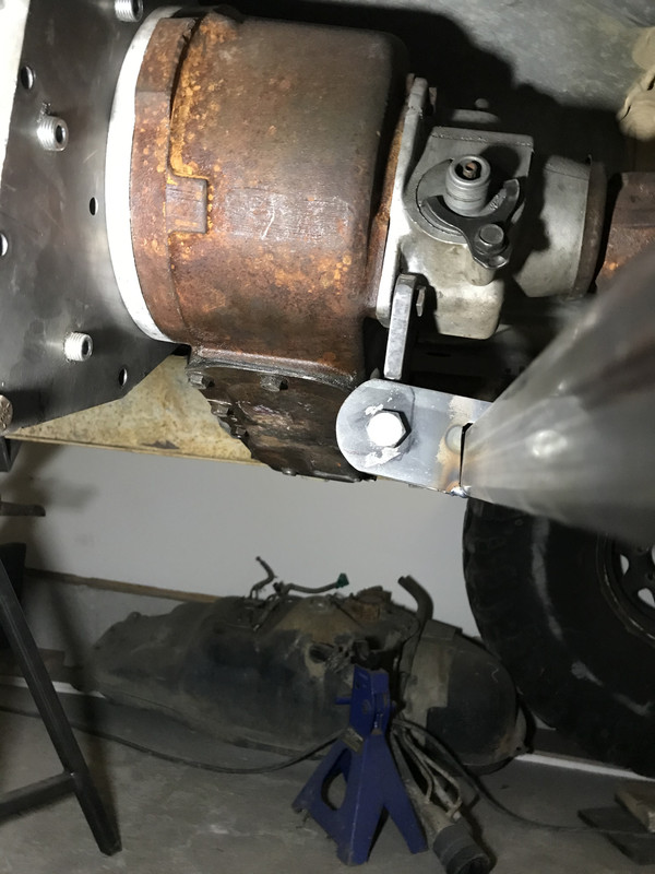

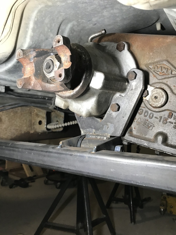

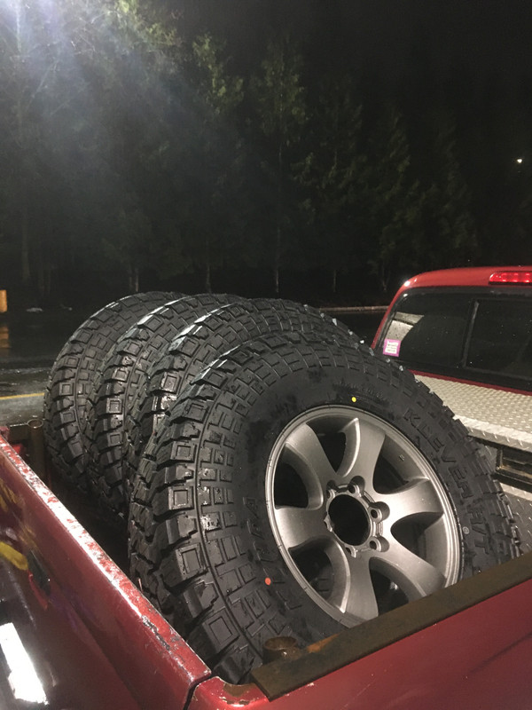

A few random pics to start. Got my DD 35s mounted and my 37s for wheelin. I put a couple wraps of gorilla tape on both sets of rims. Completed the rear t case mount and fabbed the frame side radius arm mounts.

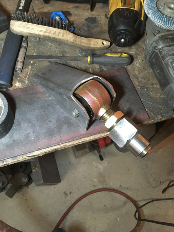

As you can see a lot of things on the front suspension are just scrap pieces for mockup so i can see if everything is gonna work before i commit to it. I just threw it together and havent a got chance to check clearances thoroughly yet. I only did one upper radius arm mount for now. The drivers side has a very narrow spot between the frame and the wide oil pan with my big poly bushing in there. First impression says its gonna work but we shall see.

I like the build a lot so far. I would urge you to make it a true 3 link though. You already have the long link up top just have to build a mount to the frame. It will hop and unload up hill a lot less and make your joints last a lot longer.

I strongly considered going 3 link but i felt a radius arm is gonna work better for 90% of what i use the truck for. Daily driving and camping. I like the idea of having the built in sway bar effect.
If i did do 3 link i probably would have bought the 4WU kit and a sway bar (if i could fit it) and thats a fair bit more cost. I really wanted to use all rubber/poly joints to minimize noise and that kit is set up to use heims in a few places. Im using poly ballistic joints on the axles and metalcloak on the frame side radius/panhard.
From what ive read, a well setup radius performs not too bad for climbing, miles ahead of a poorly setup one.
