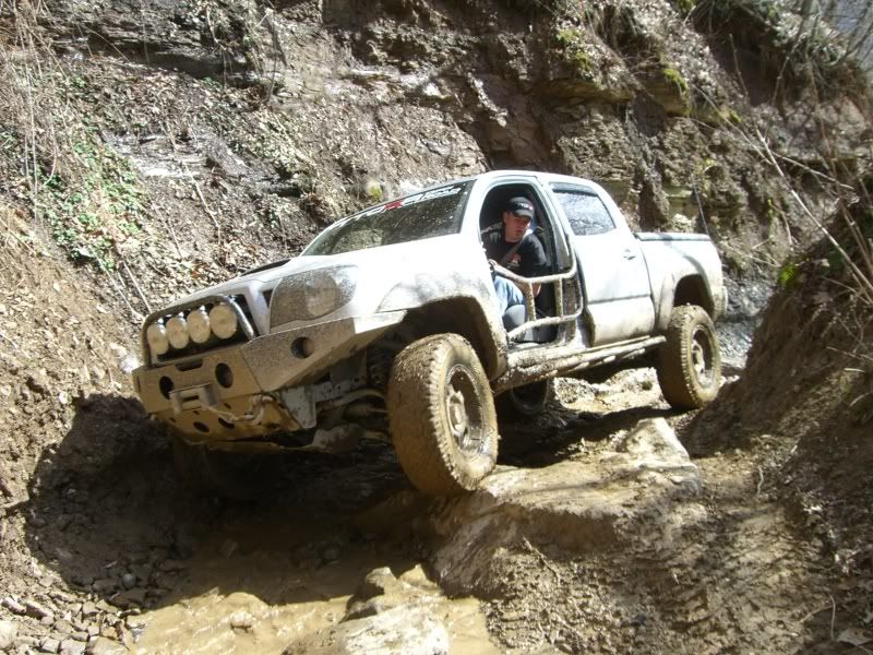

Well I guess its time. Been here for a few years now and never started compiling in one place yet. Spend more time here in the last year since TTORA went down the tubes...
Anyway...here is where I started in 2006, 2005 Toyota Tacoma TRD Sport with 6k miles...
And after the first few installs:
^^^AP front bumper, XRC8 Winch, 4x sliders, 285 BFG AT's, spacer lift, AAL
Random transformation pictures between then and this time last year:
^^^ATO Prototype Rear Bumper
^^^First and only set of 2005+ Tube doors made by yours truly :flipoff2:
^^^Fox Airbumps, Donahoe C/O, AP uppers
^^^Mini bedcage thanks to 01Tundra
^^^Added OBA
^^^Dual MV-50's and Front/Rear ARB's
^^^All-Pro Long Travel, Total Chaos Coil Bucket Gussets

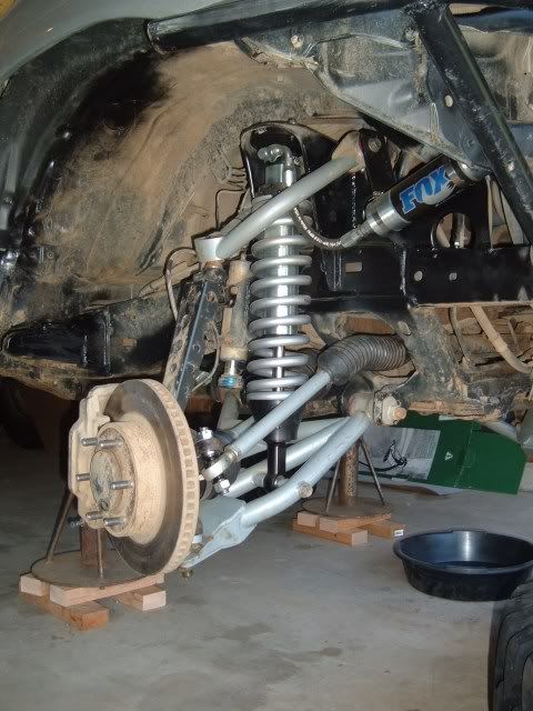

Next it was on to the front.
First I stripped the inner wheel well starting with the battery tray:
Then I removed the coilover and mounted a tire and started trimming:
By the end of the trimming it looked something like this:
I made a new wheel well out of some 20 ga, welded it in and then used seam sealer to seal it up. After paint and trimming the fender it turned out pretty good!

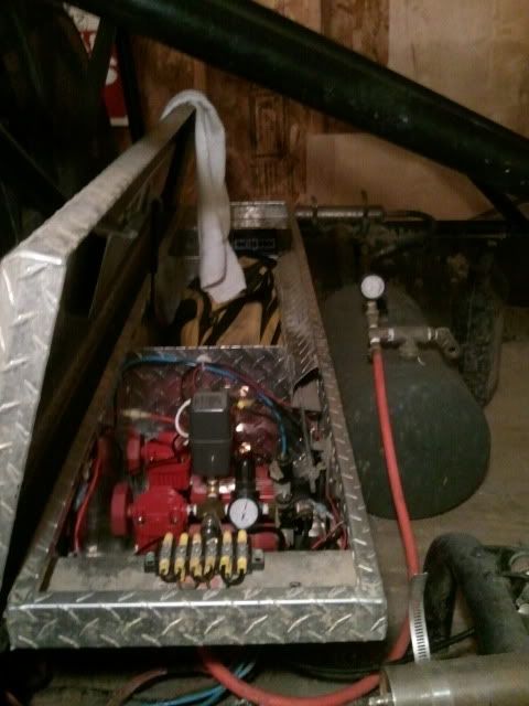

Since I raised the wheel well so much I now had to relocate the battery to the bed so I used an audio distribution block up front:
^^^1/0 Power wire not shown

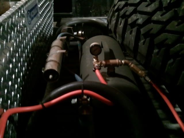

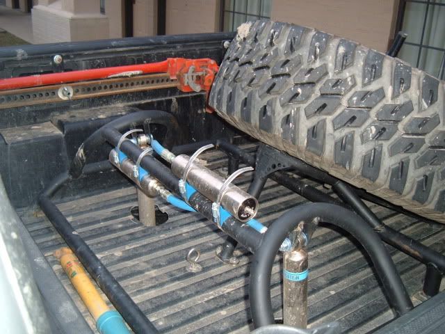

And made a quick battery box, using a few stock pieces and some angle:
Also changed air tanks to make room for my spare tire as well:
