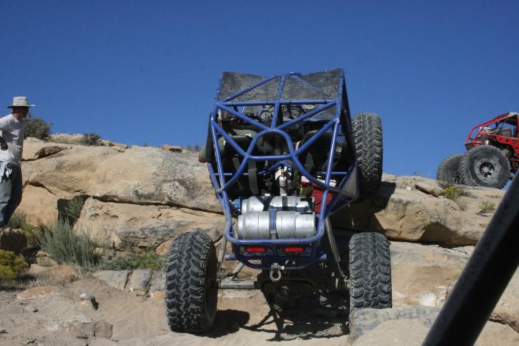

Full tube Chassis built in 2009 by Snappy from NC4x4
Competed in ECRO rock racing comp, 3rd place but now more a crawler
Located in Grand Junction, CO. $15,000.00 O.B.O.
22R, Turbo'd on propane
w156 5speed
Dual Toy cases with 4:7 in rear, dual sticked
Dana 60's
Front 35 spline, Detroit, drive flanges, 5:38
Rear 35 spline chromo dutchman's, yukon spool, 5:38. 5in pinion offset PS
Full PSC double Ended ram
Double Triangled 4 link front and rear with aluminum links
14" fox 2" air shocks front, 16" rear
WB 122", belly pan 23", 70" top of cage, 84" outside
42x14.50x18 TSL Iroks on 18x10 DIY Beadlock with ECOR locks, 32bolt
2 seater with dual tanks or 3 seater with single propane tank
Warn 9.5 with 75' blue synthetic
Purchased buggy 2010, wheeled often with no issues. Will entertain trades for other buggys or pro street cars.
Any questions call Ed 970-203-4953, [email protected]
807 Posts
This is a nice buggy with alot of thought in it, I owned it for a few months before Ed bought it, all the welding/fab work is very clean, as well as all the wiring.
All you have to do to make it a 3 seater is to remove the front propane tank and bolt a seat down, there are already brackets for a plastic seat (I'd put a nicer seat in it though).
Good luck with the sale Ed!
3,810 Posts
GLWS, I have wheeled with this buggy on 21 rd and it does great. Very well built and thought out
