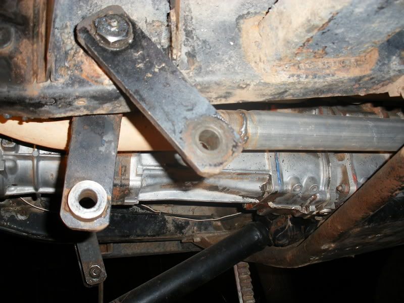

i have for now a stock front hanger, one has been ordered simply because it's super clean compared to my beat up stock hangers.

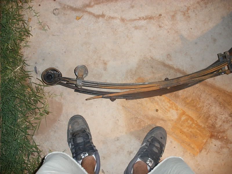

these are my TG 3" springs on bottom and 3rd gen rears

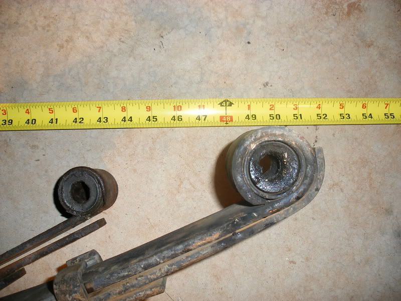

a better pic of the measurments.
after i cut the center pin on both packs, here is my "new" pack i have the TG(?) bottom 3 leaves and the 3rd gen top 2 springs.. i have the same number of springs as my original pack.

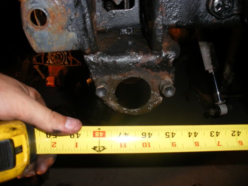

this is the measurement from the shackle maxed out at the body mount compared to my factory front hanger.
so theoretically my springs *should* be the same rate as my original pack or atleast pretty close. right?? they are longer so they will be softer right?? same rate/longer spring= softer ride
the springs are ~6" longer than my original TG 3"(?) pack

my "new" pack is 48" OAL.
should i be able to buy my new front hanger, push it forward as much as possible w/o a ton of work 1.5-2" and slightly notch my body mount?

The spring rate should be close to the same. the longer leafs will give a better ride if the shackle angle is right. i don't know where everyone else is
1,270 Posts
you are on the right track. they will be too long with the stock front hanger. you will end up bottoming out the shackle on the frame and kinking your springs on compression. the longer springs will be softer, just make sure you keep the top couple leaves clamped or you break them.
