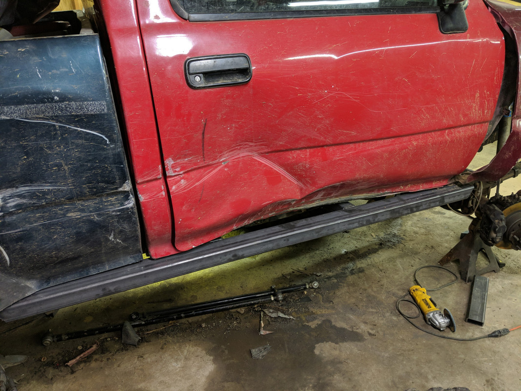

Truck started life as a very clean 2nd gen. Years ago he brought it to our shop and we did a TG sas and rear suspension. Dual cases and 4.7, lockers, bumpers and Sliders. After years of thrashing it a frame swap and an extremely extended cab/engine swap, I'm doing some more on it.
Doing some Sliders. He cut the trail gear Sliders off when he did the cab swap since they were so smashed you couldn't open the door. I don't understand why people think 120 wall is enough for Sliders. I showed him how I did the Sliders on my 4runner and he liked it. So away with the rockers and in goes 2x3x3/16 box. I used 2x2x1/8 for the frame tie ins to same a little weight since they won't be taking the hits.
Unfortunately soup bowl had its way with the passenger side before I did :laughing: if he get a new door it should be easy enough to flatten out.
Cut some simple gussets out of the same 2x2.
The plan is also for a partial exo, similar to the one I did on my 4runner. I've always hated how the b pillar on exos seem to catch on stuff, but it also sucks to hammer your door sticker area and not be able to put a new door on it. I have some ideas, but haven't decided yet how I'll do it.

Much less time consuming than round also :laughing:
I also hate round tube sliders, both for function and form.
Looks great.
I'm not against round tube at all, just has to be something substantial. For on the cheap, we used to use 1.5 schd 80 (1 7/8x.200)
I plan to build some for our 3rd gen 4runner out of 2x3 also and then have 1 3/4x188 step/kick outs to keep the rocks away.

Got a bunch done today, 188 wall is tiring to work with :laughing:
Hoop is 120, X is 090 and the b pillar is 188 plus the 120 square. Overkill on thickness, but it would have looked like shit with just the round tube in there. Hindsight, if I did it again I'd move the bar back a little and just cut the corner off the cab if that makes sense. Other than that I'm pretty happy with it.
Fender bar is kinda ugly, but I didn't want to over complicate it, plus it will be covered anyway.
