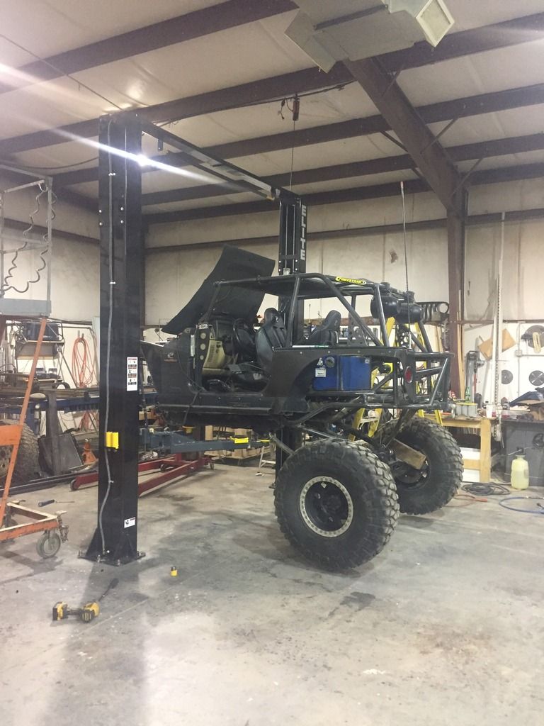

Also, super pumped to have gotten a lift installed last week, just need to get the turd out so I can get mine on it!

As much time as the Turbo Turd is eating up I've just decided to shave down the massive misalignment spacers on my pitman heim and run RBD as is. Got the suspension adjusted back out and it doesn't lift at all on dirt and only slightly on asphalt when in 4 wheel drive and turned full lock. It's not perfect, but it's wheelable AND this way I can take my time and get everything exactly how I want it.
