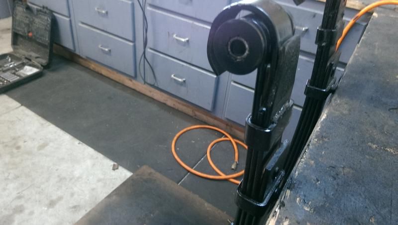

Ditched the 14s up front and got 12s. Pretty sure it was bottoming out at full articulation. Decided to order some limit straps from FOA as well, so those will help with not maxing out the shocks and with not letting the leafs arch as much under full droop.
Also got a GM alternator.
Got the leafs done, I think. I used 84-88 Toyota rears again. First leaf is the main. Second leaf is the military wrap, flipped around. Third leaf is another military wrapped leaf from another pack, with the military wrap cut off. Fourth leaf is the last leaf in the stock rears. I also welded on another clamp right near the mounting point.
I'm hoping that they aren't too stiff. The old leafs were a three pack (I added another military wrapped leaf) and they seemed to flex pretty good. I'll have to go test it out. Hope these help. Taking apart and building leaf springs aren't very fun.

New leafs in, limit strap brackets welded to frame, new 12" 2.5 resis charged and installed, all put back together. I'm still waiting on a TRE bung to make my new drag link, but will be here tomorrow afternoon. Going to weld that sucker up throw the drag link in and take her around the block to see if my brake dilemma is fixed.
