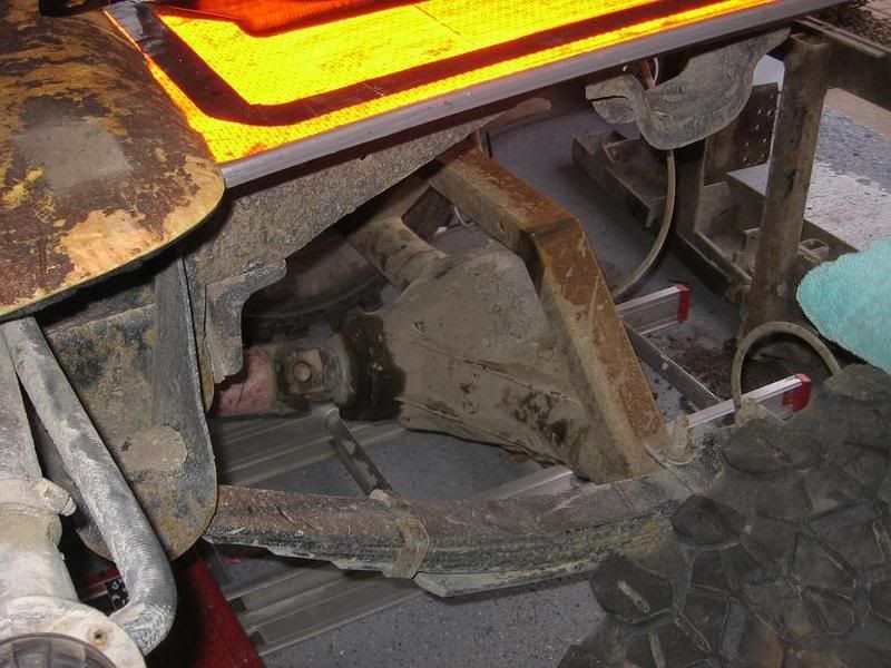

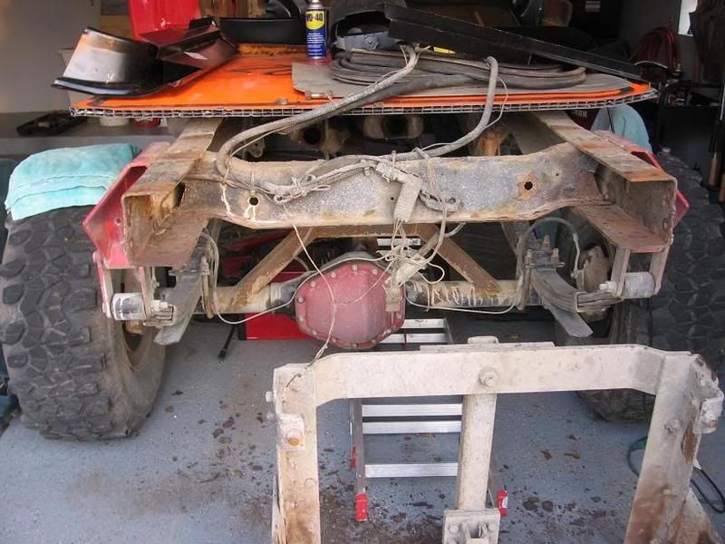

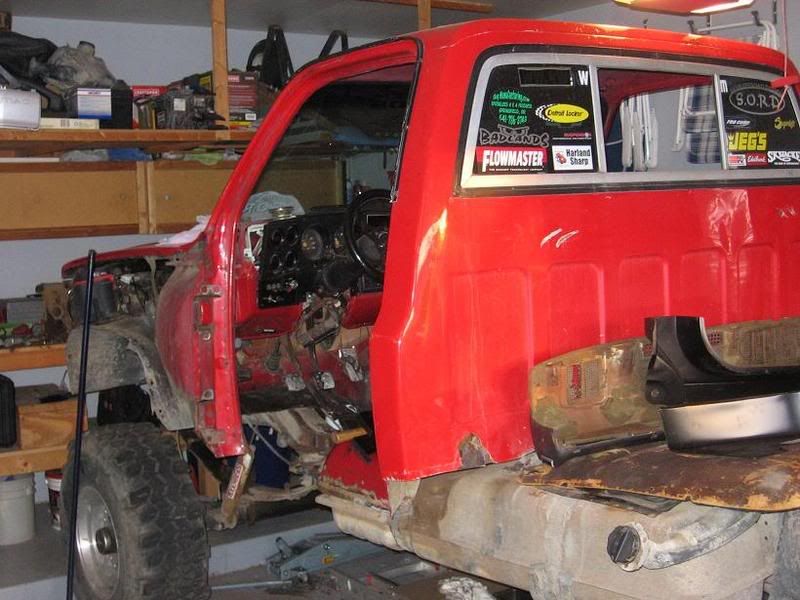

I was Asked to post this up for a Friend all I know is it is an 87 k2500 , and he is doint new floors, and a 4 link on it here are pics . Specs to follow as he is gonna post after I post this.
242 Posts
thanks for posting all the pics for me phil. but anyways thats my rig. my floors and rockers were starting to look like swiss cheese so i decided it was time to replace them. its a pain in the ass to get everything to line up perfectly. when the floors are done im going to finish the dual triangulated 4-link that i started in school. i designed and built everything for it. all i have left to do is make a crossmember for the lower links to mount to and just weld all the link mounts on and the coilover mounts. link material is 1.5" 1/4"wall dom tube. upper links are 3' 7" lowers are 4'5". heims are 3/4 x 7/8. if you got any questions or comments post up. later
i'd go bigger on your lower link material, you will bend 1.5inch .25wall tube
2,469 Posts
x2, hell i watched some 2"x.500 get bent the hell up this weekend, hell ive broke a 1 1/2x.375 tie rod in half :flipoff2:
2,977 Posts
Did i just read that someone is putting 53" lower links on a vehicle?
holy long links batman!
242 Posts
yea they are going to be long. hopefully the lowers will hold up. im sure i will go bigger but i dont have the money right now. ill see what happens when i test it out.

the upper link brackets on the truss that you guys can see are not welded in haha. i just set them on there for the pic. i dont see how the links crossing would help it flex at all. good eyes jeremy

carwash said:
this is a very weak, half-assed flip-off. You gotta commit man, stand that finger up high, get the others pulled down... weak man, i tell you, weak.
looks like a weak half-assed rod end also, :flipoff2: for a full size rig.
242 Posts
yea the joints should hold up for a while. i plan on getting bigger ones later on. they have a 55,000 some strength. i figured they should be strong enough.
4,937 Posts
Is it me....or are you going to build the whole 4-link over again? Why not just save up and do it right the first time?
242 Posts
i started the 4-link at school. i built everything there all i have to do is mount the link tabs and cut the links to length. i ran out of time in school to finish the whole thing there so i am going to finish what i started now.
242 Posts
so today i quit my job that i just got. boss was a dick about pay. but good news is i got to work on my shit all day. i got the floor, floor support rocker and inner rocker to fit just about perfect. just gotta fit the cab corner then clean them up and weld em in tomorrow. i dont have pics cause i dont have a camera. ill have to get phil over here to take some pics.

11,871 Posts
Where did you get those replacement panels? I gotta get some for my '72 K5, but haven't seen them anywhere. Nice work too.
242 Posts
well the place i got mine from is 73-87chevytrucks.com but yours is a 72. i dont know where you could get them but ill keep an eye out for ya.
