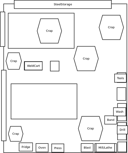

When we bought our house, it had a 34'w by 28' deep stick-built structure on a slab.
We wired, insulated (R-21 Corbond spary), heated (100k BTU Reznor), sheetrocked, painted, etc.
I'm happy to say that it took 13+ years to really start to frustrate me. :D

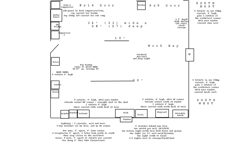

I drew this up back then, and mostly it matches..
Though I redrew it recently and turned it (d'oh) and it looks more like this.
On the second diagram, there's a man door on the bottom (north side) about middle of the wall, and on the south wall (top of picture) a window.
Shop is 34x28x10, gable ends are the N/S (man door/window)

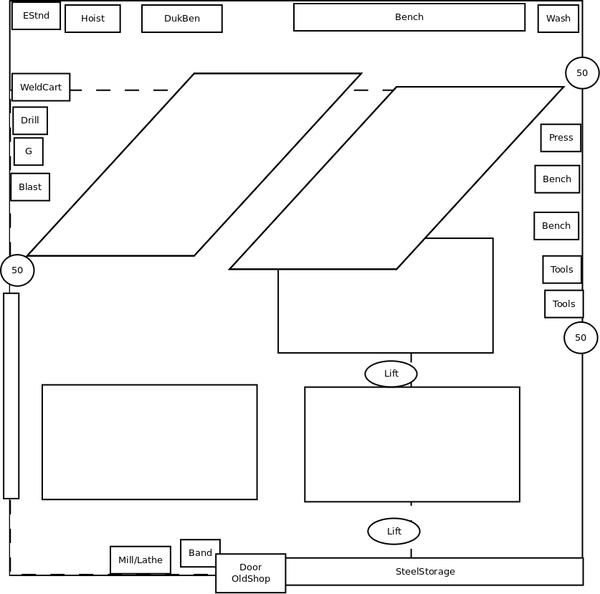

Roughly.. (dashed lines show 34x28 overlay to compare the elbow room)
This one has my favor for the moment.
One spot for a lift. Two angled slots for other stuff, and a "just inside the door" area if need-be. One of the angled slots might be parallel to the lift bay instead..
Welding/grinding in the "dead" space just behind the wall where the door is.
Steel along the wall that almost touches the old shop - I want a 20' unencumbered wall, and ideally easy to drag it straight in through the door. The bandsaw next to it just makes sense at that point.
50A outlets at least in two spots, and probably a third. Right next to the door is a no-brainer, too. :D
The other layout another buddy was trying to sell me on - all angled parking (if I put the bumpers against the wall, you could actually get 2 more rigs down the middle most days as well)
This is a workshop, not a storage building (I hope!) and I really shouldn't be working on too many projects at once if I ever hope to finish any of them..
So jamming as many rigs inside as possible isn't a concern, but some space around them is.
(Most of my vehicles are ~15' long, with a couple at 20-21' - obviously, more room with the smaller rigs)
If I could go 44' wide, aside from the bigger is always better idea, woud it be a huge improvement, or just so so?

So.. suggestions on the floor layout?

I see no air compressor. If it were me I would build a small closet in a corner to store one with a dust collector to cut down on noise.
5,100 Posts
Thanks. I forgot to mention - I think I will leave the compressor in the garage and bring the air across to the new building, too. :)

I still plan a single door - now 14'x12' high. Floor plan will still be similar to this earlier one
Still 40' from the door to the wall, but 44' top to bottom.
That should make it a little easier to get 2 diagonal, and 2 straight in at the back wall, with room near the door for at least one more.
The big door won't be right against the north wall - I'm still pondering how deep the side wall (north side, bottom of the diagram) should be.
With the man-door lined up with the window of the old shop, I should have 12' of wall between the big door and man door, and then 20-25' from the man door to the west (right) wall.
That should let CdA Metals pole steel off in the driveway, and I just have to drag it straight inside, and rack it.
The bandsaw goes on the other side of the man door, so you can just unrack the steel, drag it back towards the big door, and feed the saw.
Might still not be the smartest project I've undertaken, but I'll have a bit more room to move around, and we'll finally park a few - RUNNING - vehicles inside for the winter.
