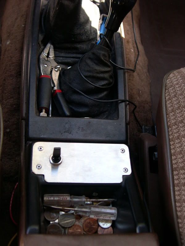

2,883 Posts
i rewired my rear window motor to a DPDT switch in the center console. i used a 30A self resetting circuit breaker and no relay.
i made a small stainless cover pannel and removed all the un used switches. it has worked flawlessly for the past 1+yr.

Is the DPDT switch the same as a polarity reversing switch? The switch I bought (up-neutral-down) didn't work because it didn't reverse the polarity like it needs to. I think my problem will be solved if I buy a polarity reversing switch... does that sound right?
Currently, since I moved last week, I ran a set of insulated wires from the tailgate, under the truck, then to the battery. When I roll it down I touch one to neg. and one to pos. and vice-verse for rolling it up.
I need a switch though...
