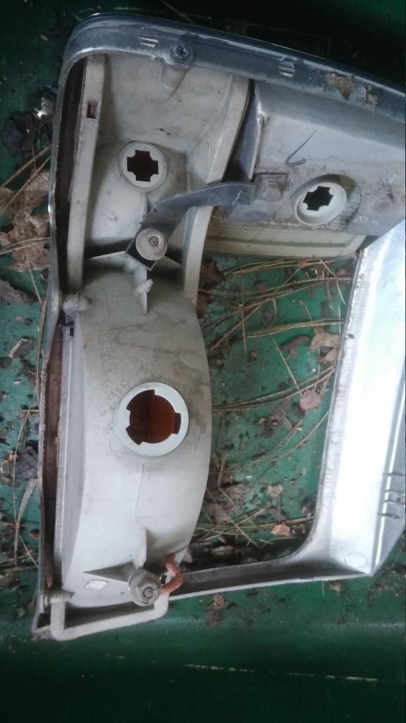

Take the batteries out along with the trays, again I didn't do this right away and it made it take much longer, then ended up doing it anyway. After that, start tearing the front end off, most of it is straight forward except for a few hidden bolts. There are 2 studs on the back of the blinker and marker light assembly took me a while to find them, you can see them in the pic.

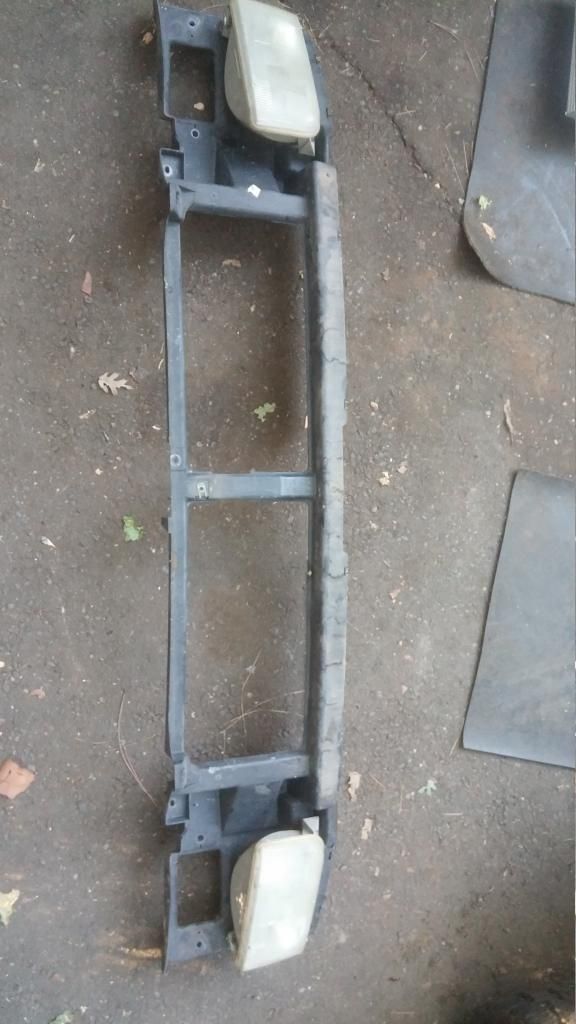

Keep taking everything off, you don't have to pull the headlights off the huge plastic thing, just pull the whole deal off.

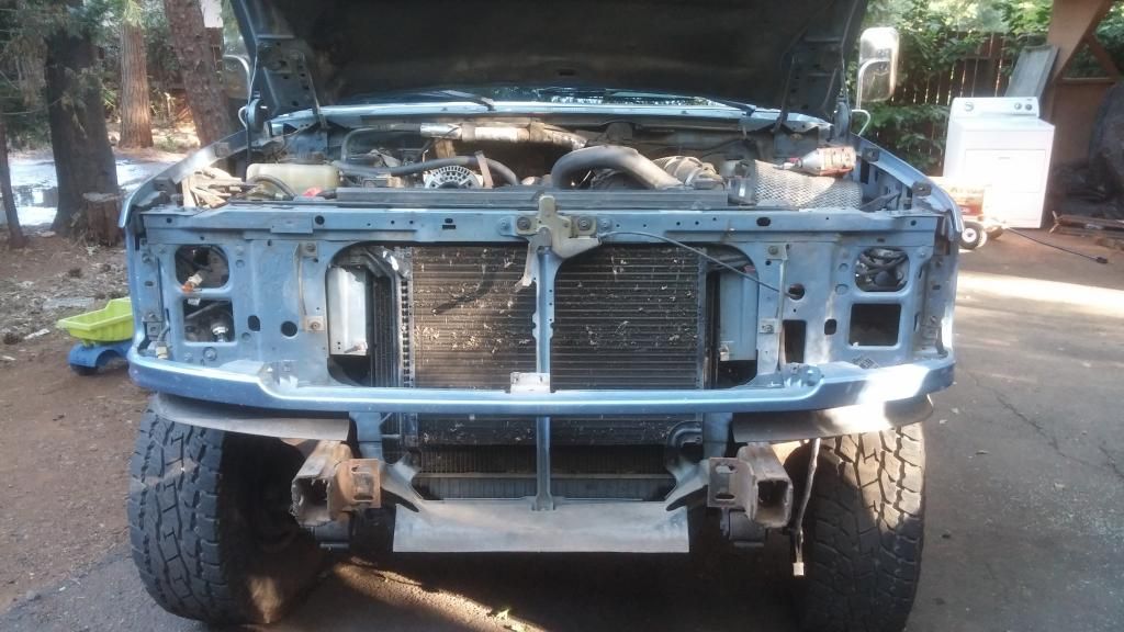

Pull of everything until you are right down to the a/c condenser. I took the pic at the wrong time. Still had to pull of the valence, and hood latch support. Unbolt the hood latch and set it in the empty battery space.

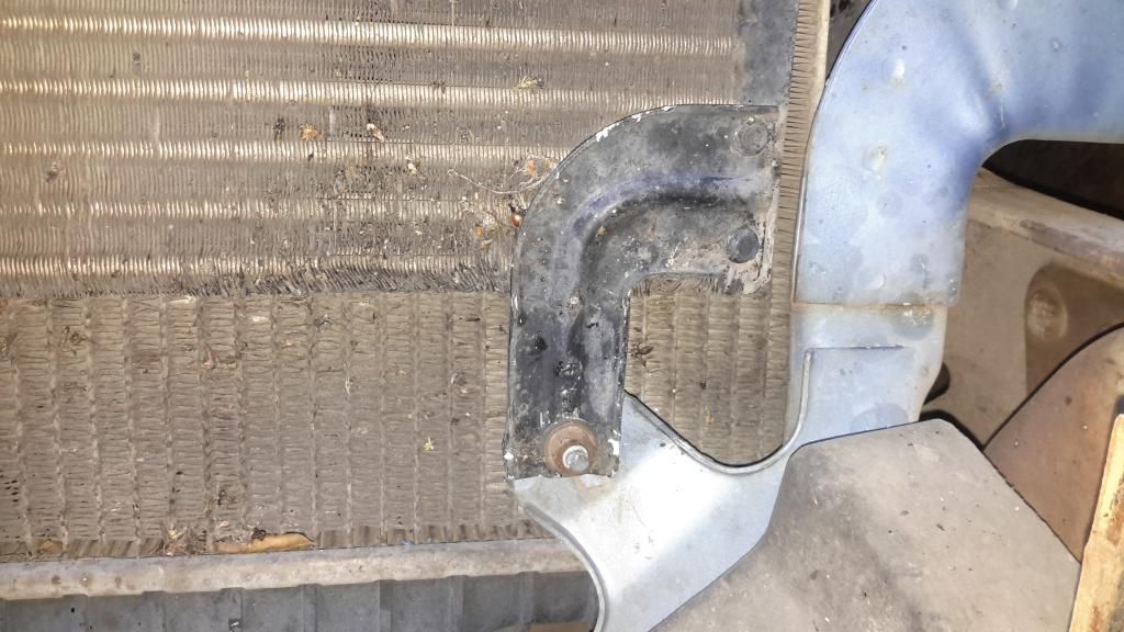

Pull off the lower condenser mounts, hammer them flat, hold them up to the holes in the condenser so you can mark your hole. Drill the hole and cut of the excess, this will push the condenser back to give you more clearance.
Driver side was cake.

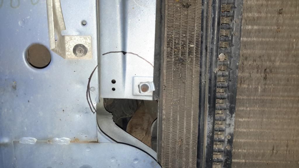

Pass side was just as easy, except the hard line coming out of the condenser was, ever so slightly, touching the core support. I didn't like that, so I hammered the lower mount back and bent the core support piece forward a little with a Cresent wrench.
Next flatten out the center support where it used bend around the condenser. Cut about a 1/2" off the bottom, right through the existing slot. Now you can use an angle grinder to extend the slot up wards to make up for taking the bend out. I think about a 1/4" is plenty.

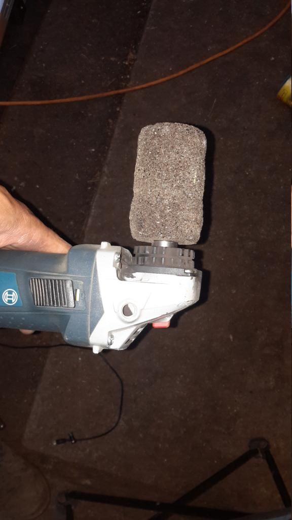

I ended up cutting a little more than what i marked, but I like to start small and work my way up so you don't end up with a big hole. I started with a cut off wheel, then a Sawzall, and then cleaned it up with this:
If I had to do it again, I would drill a bunch of ~5/16" holes, connect them with a Sawzall and then clean it up with the drum thing in the pic I posted. I forgot to take pics of the finished holes, that's about where I left off for the night. I'm trying to figure out how to mount the top 2 rubber bushings. I think most people just drill and bolt through the core support, but getting to the nuts on the back would be a huge pain in the ass. I think I am going to drill and tap a piece of 1/4th flat bar and weld it to the core support.
