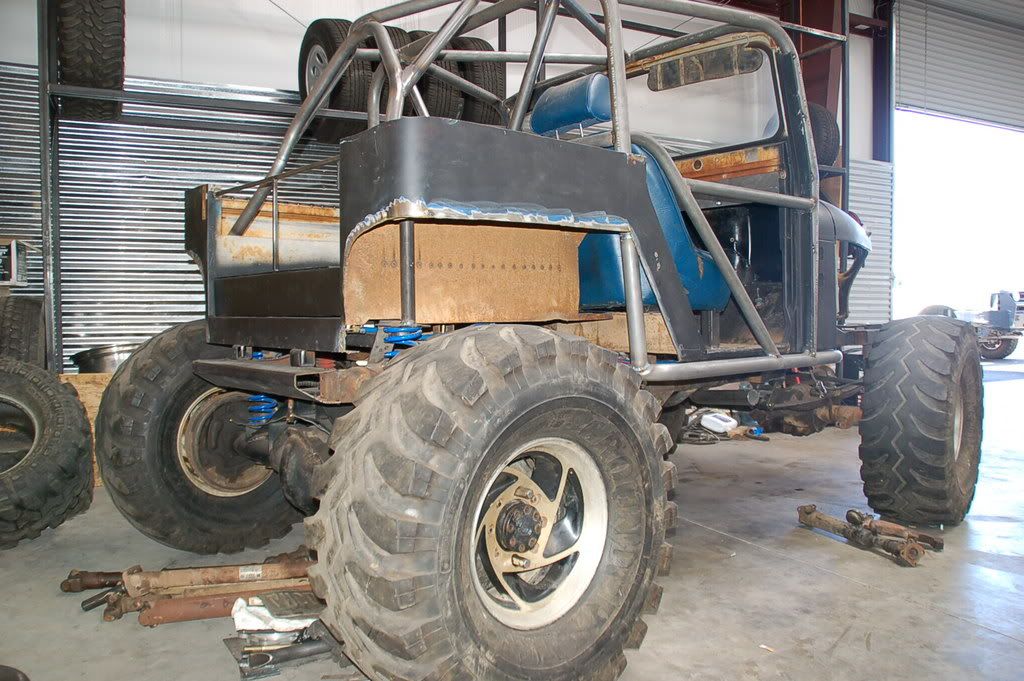

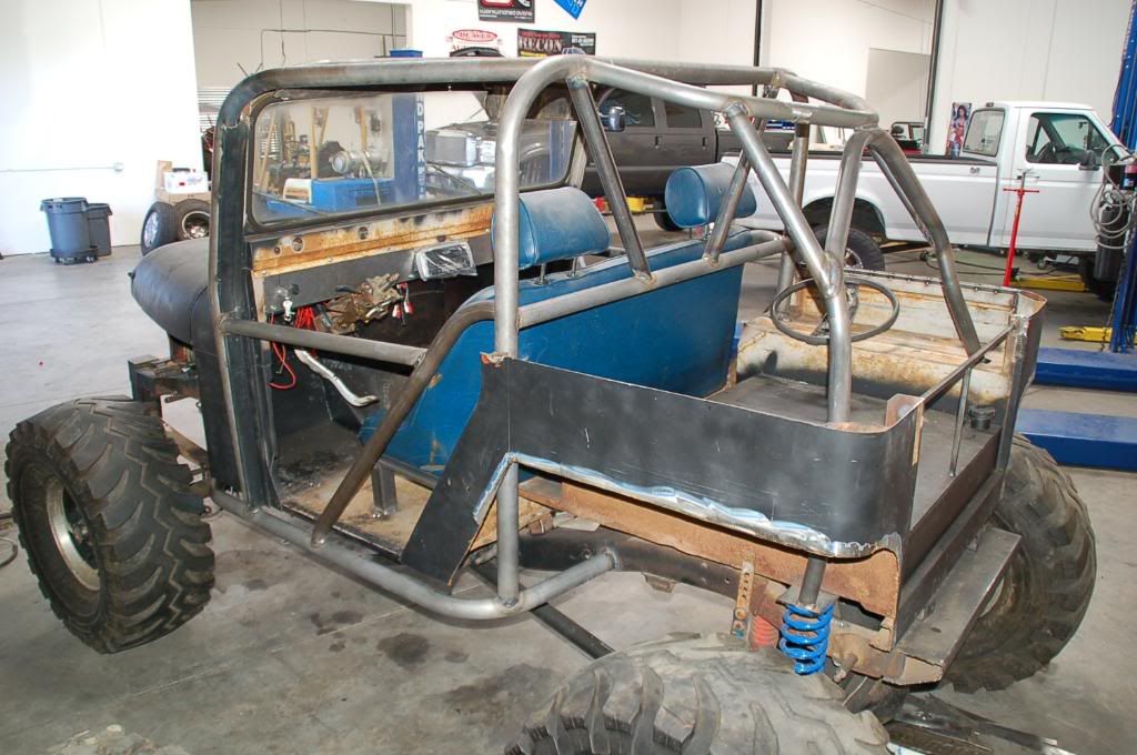

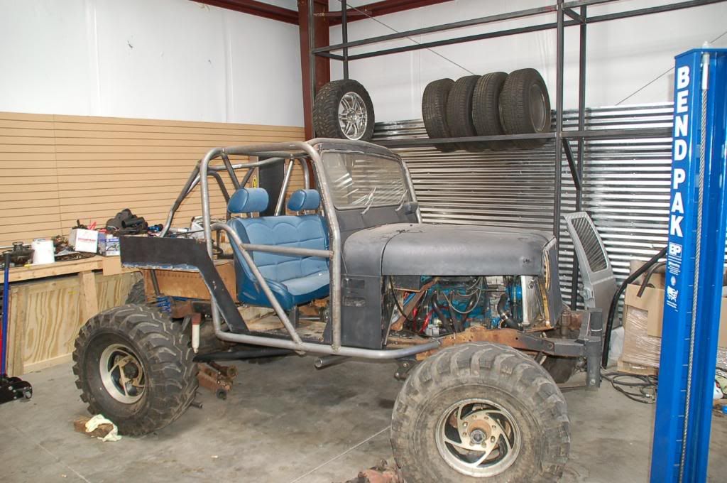

Well I figure it's a little late but heres were I am at with my build Jrodd been bugging the hell out of me to get it on here.
44 HD front still leafs there chevy 52's
welded spiders 4.10's
Corp 14 rear locker 4.10's
three link rear suspension on coils
231 buick V6
turbo 350 trans
toyota gear box
40" ground hawgs on 16.5's
All major cage work is 2" dom the rest is 1 3/4 dom except a few braces
well anything else just ask an i'll try to keep it going an current now
oh yeah it started as a 60 willy's mail jeep

Well I was told that I need TECH not sure if this is what I need but I'm posting this build for advice an ideas on what the hell I can do with this shitty front end till i get a 60 an any advice on finishing my front tubing an rear exo.

Looks good, would look better with the chick that delivers my mail driving it though, but you'll do!!!
Wondering about the thickness of the coil mounts? Be careful with the thickness of those. The heavier axles tear apart suspension parts pretty fast.
What your height and skid plate clearance measurement? Looks a little tall, might be able to lower it a couple inches by reducing size of the front leaf mounts and mounting the rear upper coil plate a little higher.
850 Posts
please tell me you are keeping that rig RHD. shitty front end? i dont understand.
311 Posts
buy some new body mounts
why ground hawgs? why make it LHD like almost every other rig in the US, why the funky little bends in the back tubing and why are the door bars so high?
