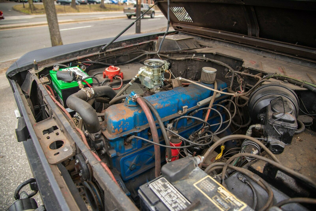

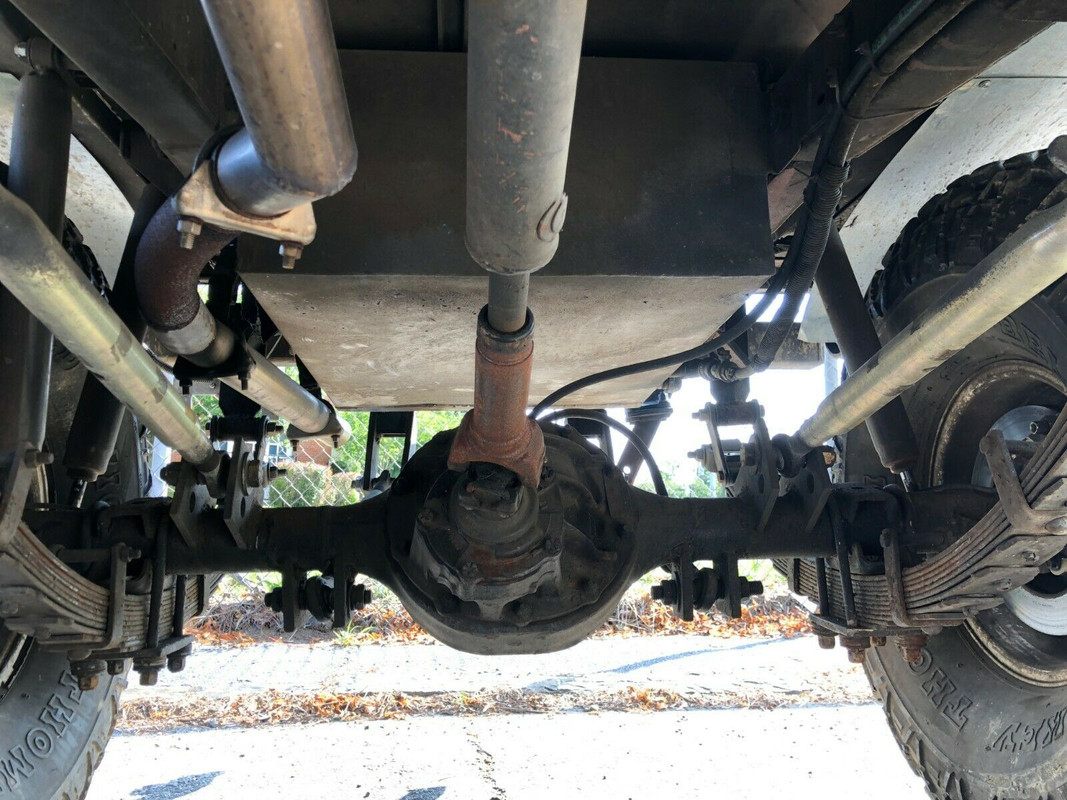

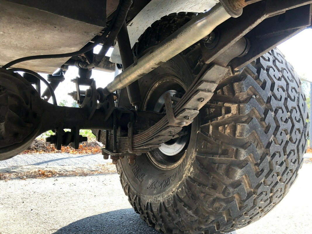

I have a 71 Bronco with 38" tires, 4.9L/300 and an NP435, and I need to change the gears to make it highway-friendly, but still keep it offroad capable. As it is right, it way too low, it's set up for crawling and it doesn't pass 40 mph. I don't know what's in it. I was thinking about putting 456s.
I changed the tires to 38x13 (the ones in the pics 39x18.5)
Any thoughts? Thank you.

It's on top of the 4th gear with revs are out of the roof and engine screaming. It was set up for hardcore crawling.

With 5.38s, youd be 2k rpm at 40mph.

Also, are you sure it's a 4.9?
That is not a commonly (like ever) swapped motor into an EB.

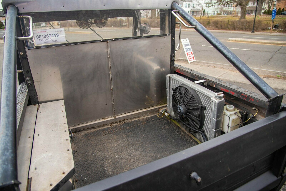

Hi, I know. But the previous owner put a 4.9L/300 long block and moved the radiator to the back.

maybe he has d60/70s with 7.17 gears
probably not though :flipoff2:
It sure feels like it, if not even more. I have no idea what's in there. This is my first offroad vehicle. 1st gear screams to change at 7mph.
