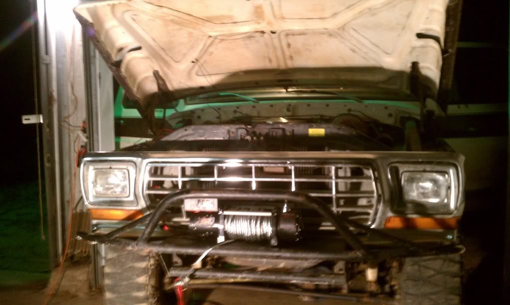

Update:
Still have the old truck and wheel it whenever I can. It's basically setup exactly the same as it has been, seems to work well. Only real change is a set of 35x12.50-15 BFG ATs on factory Ford wagon wheels (late 60's or 70's vintage). The wheels are off-white/cream color, looks real retro. :smokin:
My original steel wheels that the Q78's are mounted on have become so bent the truck was undriveable over 30mph. I'm still using them on the trail, but until I get some new wheels for the swampers they are trail only. The new BFG's on straight wheels ride so smooth its unbelievable, the truck really rolls out on the top end now. Only problem is they also hook up a lot better on the street and make the rear spool very noticeable. Might have to look into a selectable rear locker or at least a standard locker instead of the spool in the future.
I'll try to get some pics in the next few days, everything is covered in ice/snow right now.

- Realized the night before we were leaving the diaphragm on the vacuum advance on the distributor had gone bad, which could explain why the motor hasn't had any top end power for quite some time. :laughing: Installed a new one at the trail head, quick check of the timing and it was running the best it has in a while.
-Carbs don't like sitting unused for long periods of time. For the most part the carb ran great except for occasionally running really rich at idle, and once when all fuel delivery stopped halfway up a full throttle assult on Hell's Revenge trail (which lead to an equally quick decent, backwards, with all four tires locked up :eek:) Probably time to tear it down again and give it a good cleaning.
-Time to do something about my wheels. All four steelies are bent to the point of being undriveable on the street and I have constant trouble with bending the outter wheel lip and getting crap in the beads at the single digit air pressures I like to run. Some sort of homebrew beadlocks are my next step.
Hopefully more pics/vids/tech to come in the near future.:smokin:
