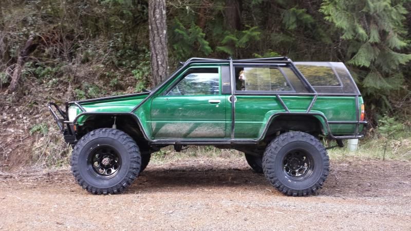

1986 4runner currently it's setup and looks like this:
37x12.50x17 radial Pitbull Rockers
Procomp wheels 17x9, 3.5 backspace
ARB's front/ rear
Birfield eliminators
5.29's
4.7 transfer case
Chevy 63+ a couple leafs
SAS/ RUF 8 leaf pack, TG hanger, Boomerang shackles
headers, magnaflow exhaust
Upgraded cam
v-6 brake booster/ cylinder, proportioning valve removed, v-6 drums
14" front, 12" rear shocks
TG front driveline
Rear fenders cut
steering box moved forward, flat pitman arm, frame plated
Ford Electric Green single stage enamel
homebrew exo

So when I first got the rig the original owner had put chevy 56’s in the rear and what I believe to be some type of waggy springs in the front? They had a huge shackle mounted to the bottom of the frame. While it drove well… I was afraid they would get snagged on everything, so they had to go.
I built a RUF pack which was a little soft but I ran out of leafs so I made it work until I can get some TG 3”. I only have about 1.75” of up before my bumps hit which result in some painful speed bumps. Articulation is decent but speed hurts.
So since I messed with the front, I wanted to improve the rear as well. I went with the 3 leaf Chevy 63’s with overload… unfortunately I didn’t get enough lift so I kept the blocks under them. Im debating on putting another leaf in them from the 56's and pulling out the blocks. Just can't afford a complete TG overhaul right now.

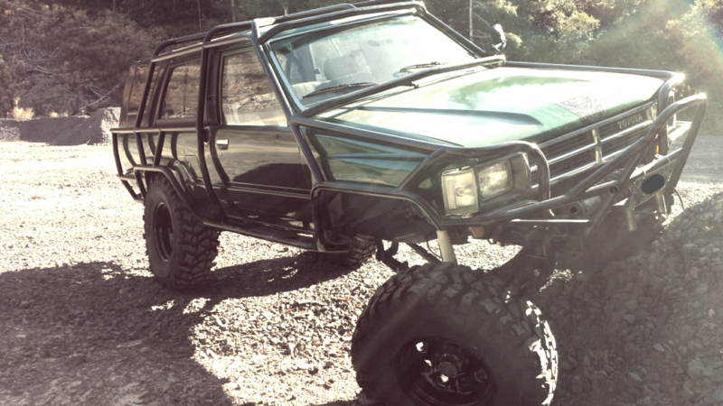

Went together pretty simple. This was my first attempt at anything like it. I was still fairly new to welding sheet metal as well. All in all it’s straight and seems to be working just fine. The integrity has obviously been extremely compromised, so an internal cage will be my next project.
I also learned that angle grinders are not to be messed with…
The spare rig also gave me spare doors. I took the old bent ones, cut them up, and made some pretty clean half doors. I gave them “soda” holders and carpeted the inside. I also installed speakers with quick disconnects and did the same on the other set of doors. The new doors were electric so I ran them for power for an instant upgrade!
I braced the inside lengthwise on both sides, this also gave me more material to weld to. for the side pieces I just welded the seems. Seemed to work. Even with the doors being destroyed before, they turned out straight with very little bondo.
Since I carpeted the doors I also pulled out the rest of the old interior and made new side pieces. I carpeted everything to match… including the dash.

id go exo so you wont have to reskin it again to stop water leaks it rains here in oregon.
take it to matt and tonys shop on broklyn they can do good tube work at affordable cost
