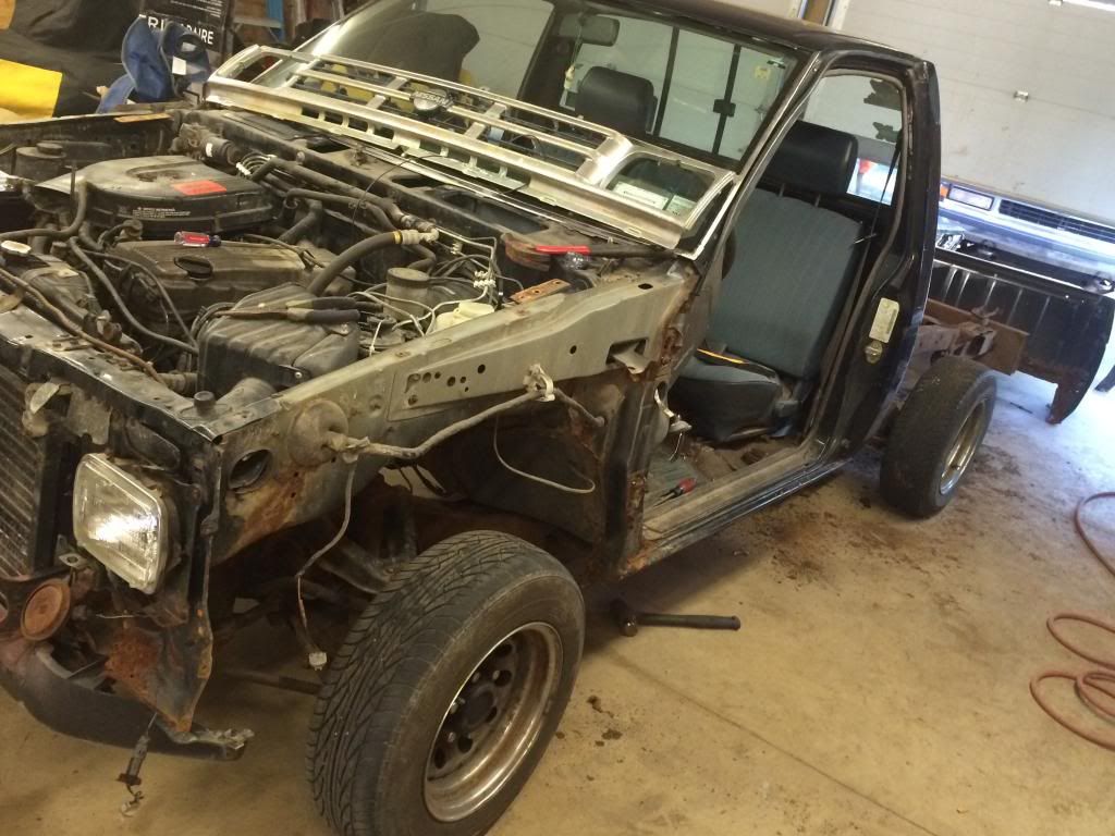

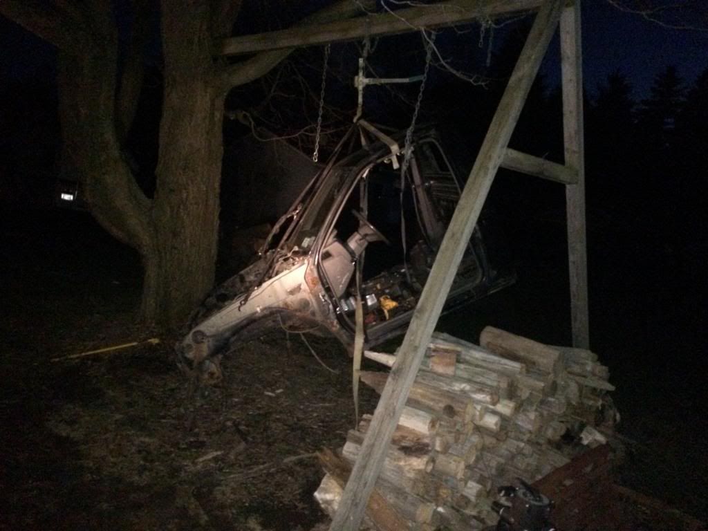

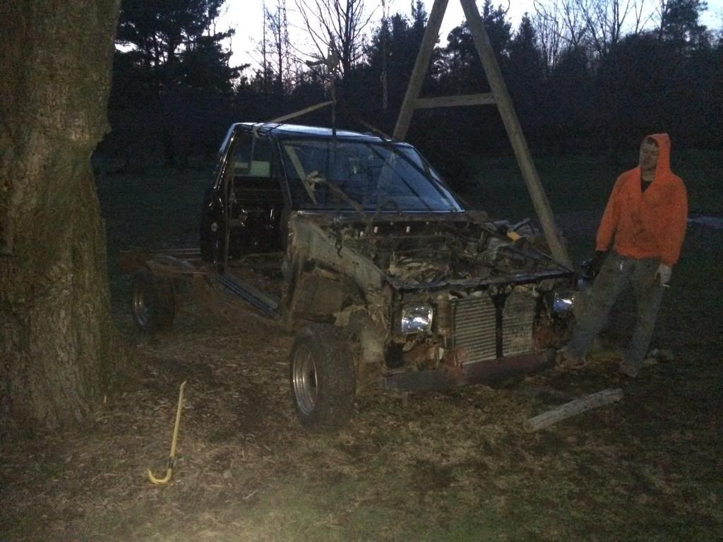

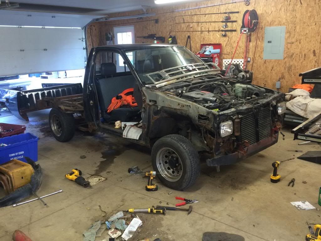

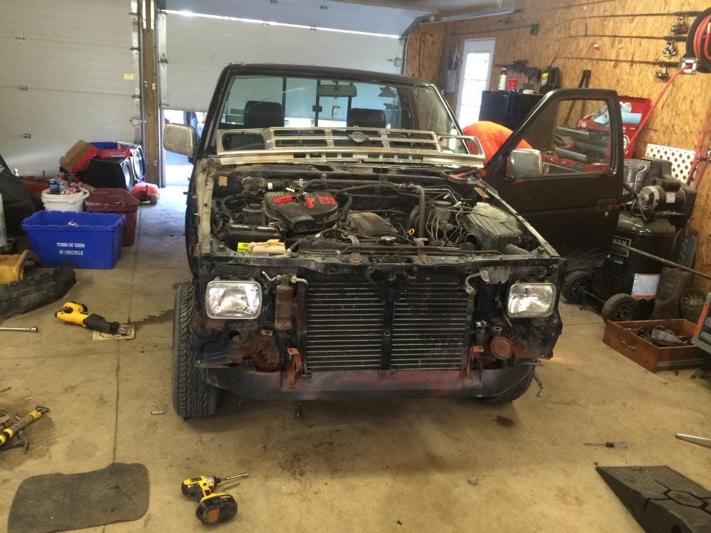

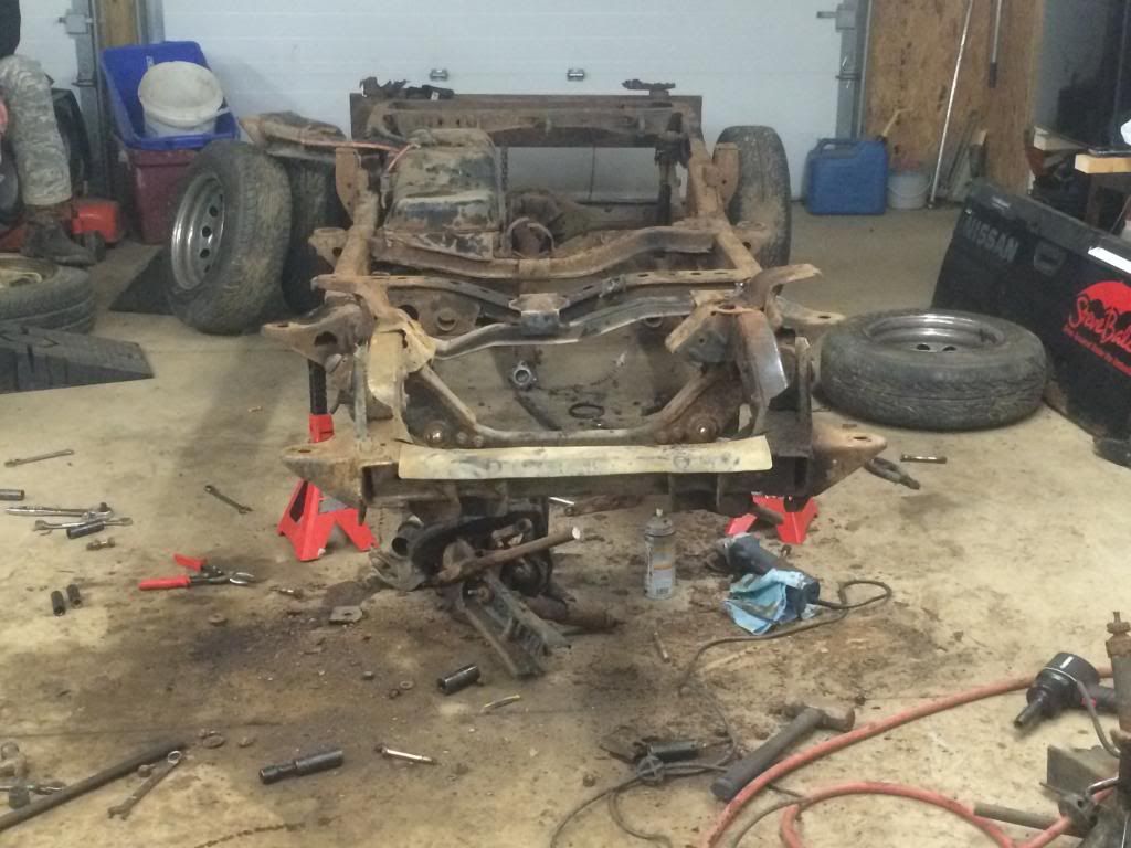

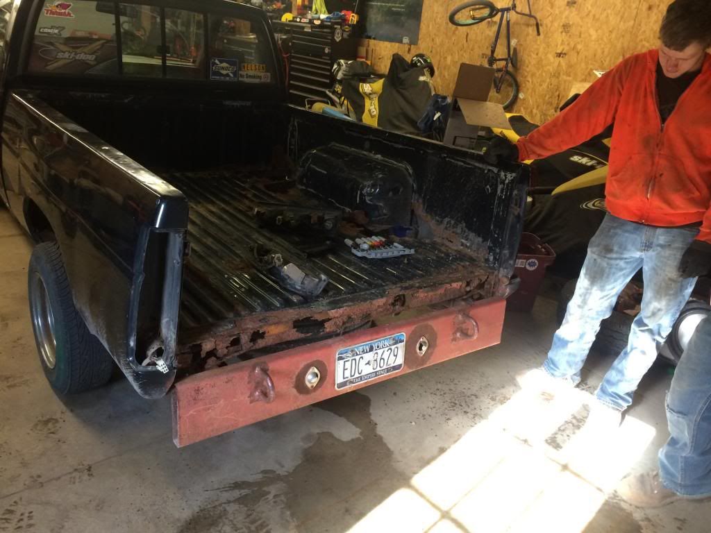

This is a project a couple buddies and I have been working on. It's a 91 d21 that we are completely rebuilding, originally the truck was a 2wd 4 cyl 5 speed.The plan for now is 10 bolt chevy front 14 bolt 6 lug rear chevy 350 TBI turbo 350 trans and a np 205. We're waiting on a shipment from ballistic fab now but here's where we're at so far.
whole truck was pretty roached from living in NY it's whole life and 350,000 miles
That's where we ended the first night
Back at it the next day

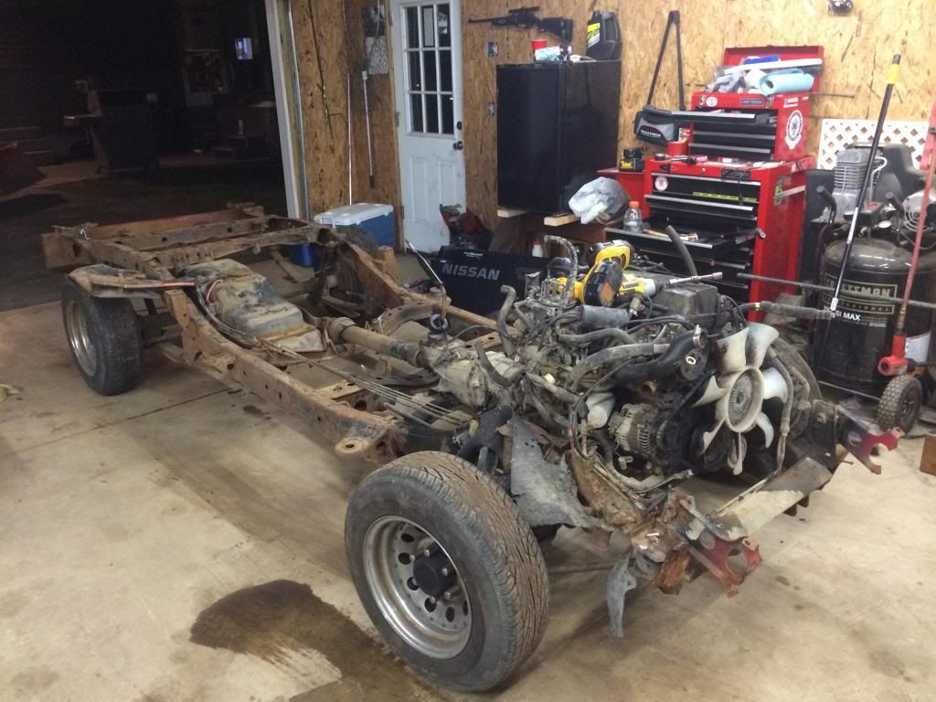

Cut the frame just behind the rear cab mounts the back was so rotted it wasn't worth trying to save and it's easier to build from the new back half.
After the amount of rot we cut out and replaced it would have been less time consuming to just build a new frame but it's all solid now.
Seeing how the new back half fits.
Brought the front axle home.
And this is where we finally called it quits last night at 4:30 in the morning backhalf is welded in and front axle is torn apart.
46 Posts
This is where she'll sit until our order from ballistic comes in then we can start fitting the front end up. We'll keep this updated as we go it'll be a slow build as we usually only get to work on it until the weekend.

You killed that truck in a day! Wow. Good luck putting it back together.
46 Posts
Discussion Starter #5
There was 3 of us working so it wasn't too bad to rip it apart going back together will definitely take awhile only thing nissan will be the cab and half the frame. We're hoping to be wheeling next spring.
