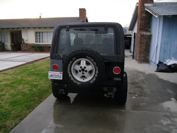

Not much to start with...figured I would post some progress pics...
day I brought it home...
trimmed up the front bumper, removed the flares and added some pillar lights.
(hard top on)
repaired some body damage to the lt corner and flushed in a set of LED taillights.
added a set of Chevy Cavalier seats...(old ones were completely trashed)
fabbed a set of rock sliders...
painted the repaired corner...
scored a besttop softop and half doors...also a procomp rear bumper

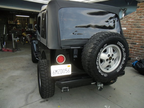

continued
also fabbed a set of front tube fenders.
painted to match
I also flushed in a set of LED side markers to keep it legal
I have the lift shackles on it now but eventually want to change out to 4" lift springs.
Next project will be cutting the rear wheel area out and fabbing a set of rear tube flares.

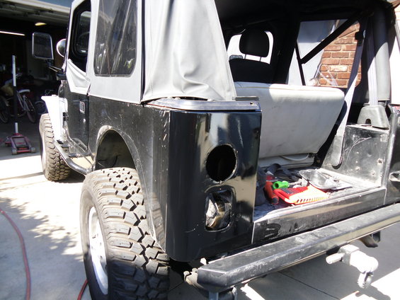

rear tube fenders...
also 1.5 tube .120 wall, with 16 gage flat stock.
also picked up a quick lok for the rear dana 35 tooth pick axle.
after installing a detroit in my 14bolt its absolutely funny how small this thing is...
705 Posts
can you show the wiring on the LED's???
i am trying to get mine to work, but they are on all the time when i wired them in...
2,360 Posts
Discussion Starter · #7 ·
just caught this, I just used a test light to find which wire ran what on the jeep and then attached them to the light in that order.
