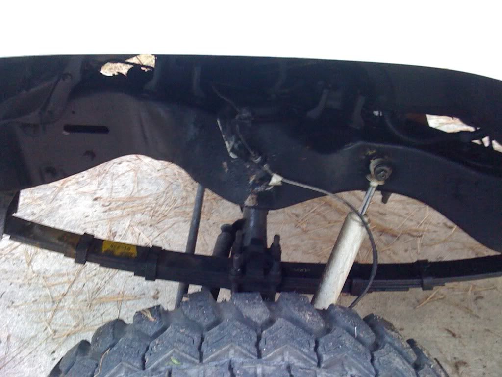

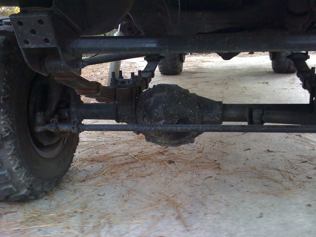

hey just bought a new truck and had some questions about finishing the 4x4 on this truck. The lift is all done right and drives nice but the truck was a 2x4 so still has the 2x4 tranny with no transfer case.. not sure my options with have a big block and an older chevy axle with the pumpkin on the passenger side.. any ideas?? thanks

Lets see here, crew cab + big block + big tires + 10 bolt = :homer:
Post pics of carnage!
You would be better off just leaving it a 2wd...... seriously.
1,808 Posts
Dang its a nice truck but looks like someone just stuck a 10 bolt under it ....
If you want to keep your current trans then your go for a divorce mount 205 ... search it will give u all the info you need
Or you can use a married setup and find a 4wd tranny with a passenger drop t case of your choice ( well not really your limited to 6 bolt round pattern case )

what about a 4l80e-205 adapter from advanced adapters and a figure 8 32 spline chevy case

According the sticker on the spring there 8" Superlifts for the front of a 73-86 blazer. so 46"
I agree with what was already said, you need to address some other issues before you connect a driveshaft.
