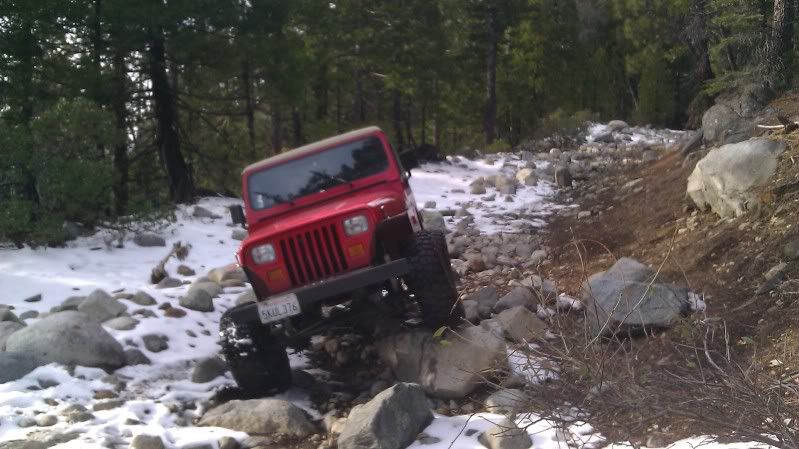

So my rig is to a point now that I thought I would stay away from :shaking::eek: But im sure a few of you know how that is.
Started out selling my blazer for something "smaller" and "cheap" and "streetable"
But it didnt take long.
So my goal with this rig was to be cheap. I dont buy anything unless I have to. That means making all those stupid tedious brackets and such, but It gives me a sense of accomplishment.
In my current state I have under 7k in the entire rig, thats including purchasing it.
Jeep has earned its name of Snowball. Because it keeps snowballing into something more than it was intended.
So started out as:
95 with the o so peppy 2.5 4 banger. 5speed with a teralow 4.0 kit on the 231 with a SYE.
4.5in rubicon express extreme duty lift. Spring under. d30 front d35 rear with 4.56s. 33in bfg km2s with only 1k miles. Also a brand new 33in baja claw spare. And it has a hardtop
Put a locker in the d30
Wheeled it like this for a while I was suprised what it could do for what it was.
Didnt take long untill i started messing it up.
Made some miniboatside sliders since the rockers got demolished in short order.
No brake so I cut and welded and sanded em smooth.

Made some tube fenders.
Maiden rubicon trip
Blew up the dana 35
Picked up an 8.8 to replace it.
Was supposed to be the endgame axle :laughing:
Took it to fordyce. Just past sunrise hill
Made some poly/lift motor mounts
Did the tank bump mod. Waste of time. Never even used it.
Redid mounts and made a flat belly, Was a big improvement with the 33s.

Picked up some 35s. Shocks didnt approve.
Also got rid of the foul YJ grill for a TJ grill.
Then it started going downhill.
Wanted to stretch the rear out with xj springs sooo...
Comp cut it and stretched it 6in.
Wheeled it for a while like that. It did really well with the added wheelbase and that tire.

231/300 doubler
And did this to my floor to make it fit.
So the d30/8.8 didnt last too long.
Did spring over with stock yj fronts and threw a set of 3/4 tons in.
10b with chromos/lockrite, etc. 14bolt with detroit/discs.
And the crappy Mil MT tires.
I was happy with how it performed. The width was a nice change.
Decided to change up the vice grip shifters i had and built a set of cable shifters.
Little RTI action

So then it was time for a cage.
Found a killer deal and picked up a set of h1 beadlocks for 200 bucks.
Another rubicon trip. This time tahoe-wws.
Made up some corner armor, reusing the half corners I had before.
Threw some tube at em. Was a major pain :mad3:

Whoops.
Twisted front driveshaft, then blew up rear yoke 2 secs after.
Added more to cage
Picked up a winch finally. Its been a lifesaver.
Another fordyce trip. this time to WH3. I was alone and had never been there before. Was a great trip though, other than shredding atire.
Made some rock rings for my wheels, since I had messed up all of them bashing them on rocks.
More rubicon.
More to follow

So the 3/4 tons worked for me, but I enjoy going fast on the rocks, and i knew the 10bolt would not enjoy that for long so I grabbed a d60.
Went with 4wheel supply arms and ran the tierod behind the axle. Welded it up and Also threw on hydro assist.
First trip out and i did this
So that turned me off to leaves even more than I already was. Seemed like a shackle reversal was a waste of time. So i decided it needed to be linked. And soon.
Figured since I had a 60 front It was time for bigger tires, So i got some 39.5 Iroks.
Did a Rubicon run in the snow. Was a ton of fun. New tires did great.
Got the Go fast bug after some playing with leaf packs, and shocks.
Pre running the rock piles - YouTube
