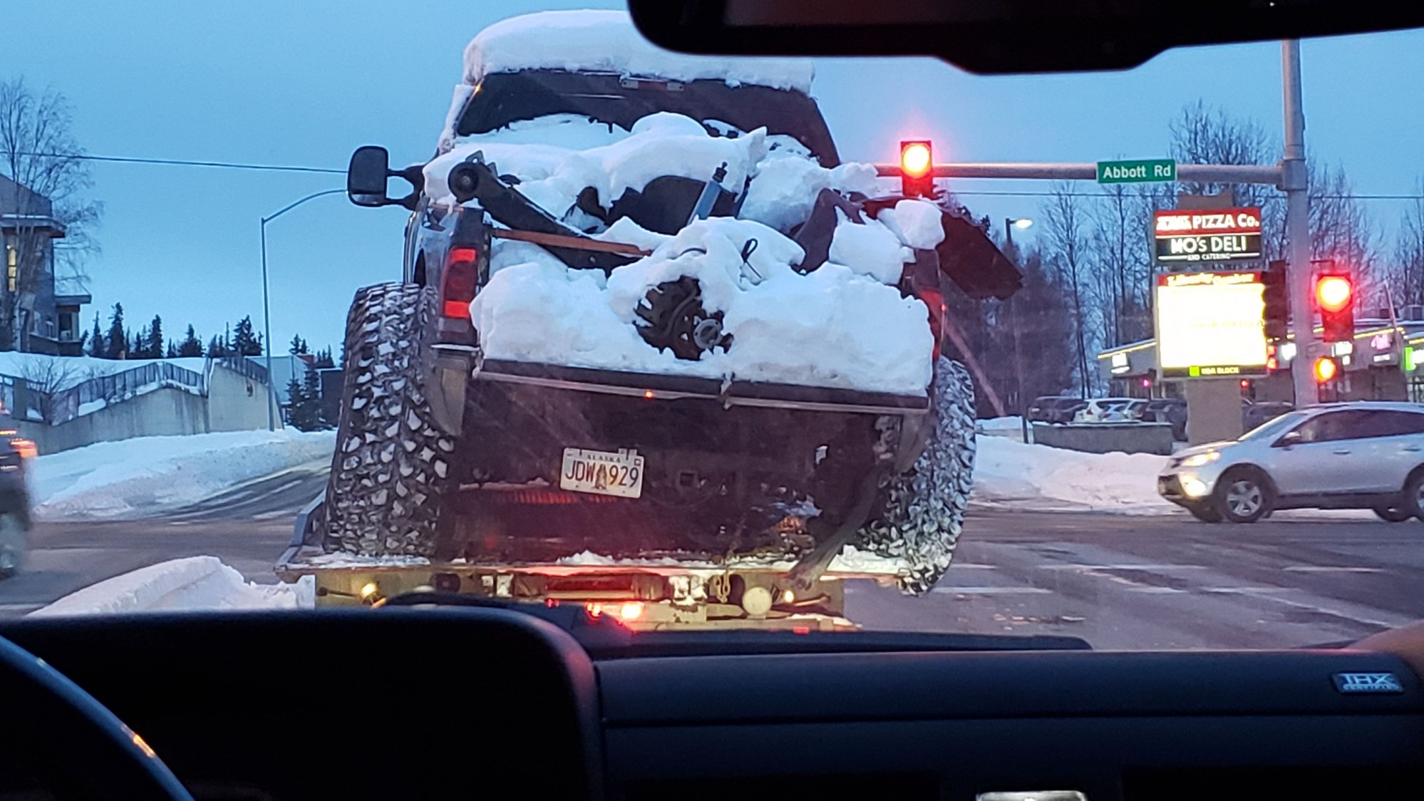

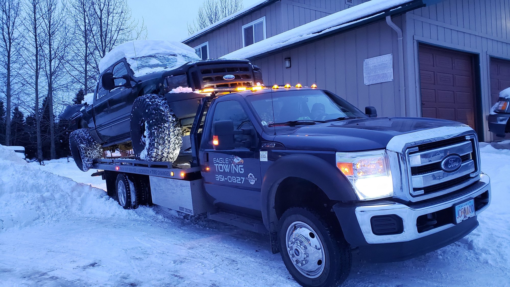

from when we first went to go buy it
tow truck driver was loading it and popped the bead on the rear pass tire. he was cool with taking still though and went for it

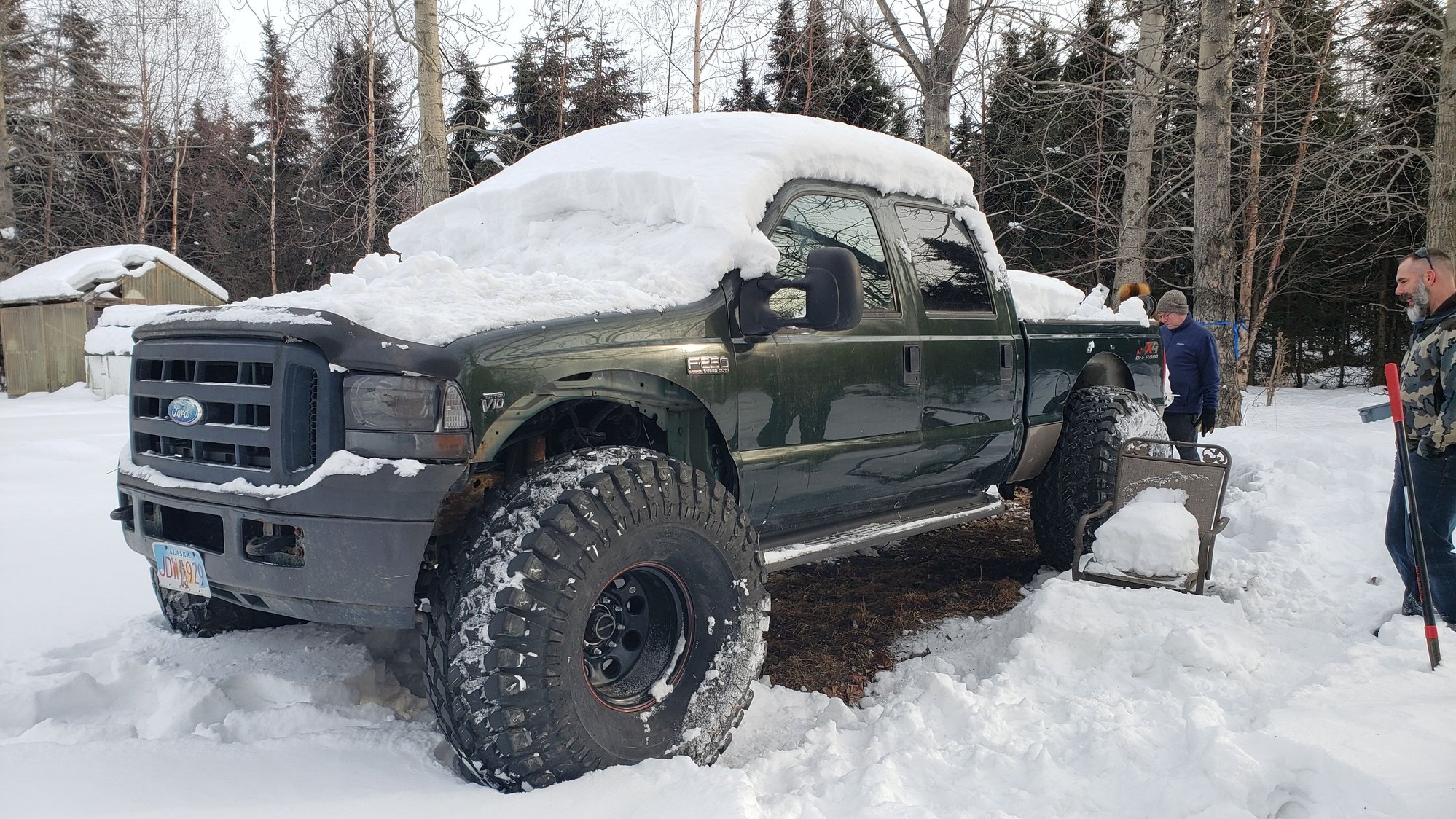

seemed sketchy to us haha
47s vs 35s haha

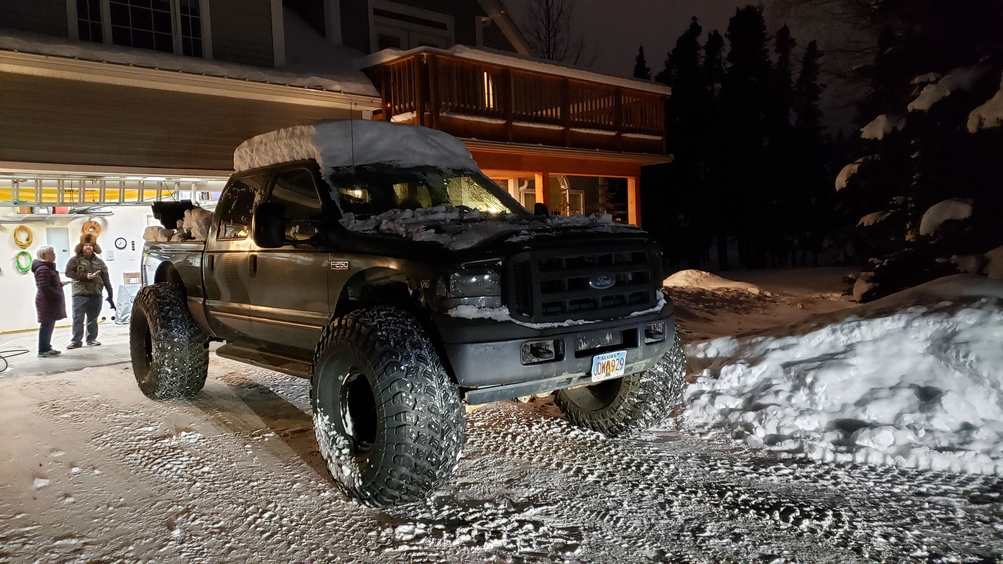

so first step was to get it inside and start thawing it out and assessing where its at.
got a spare set of smaller tires to make moving around easier

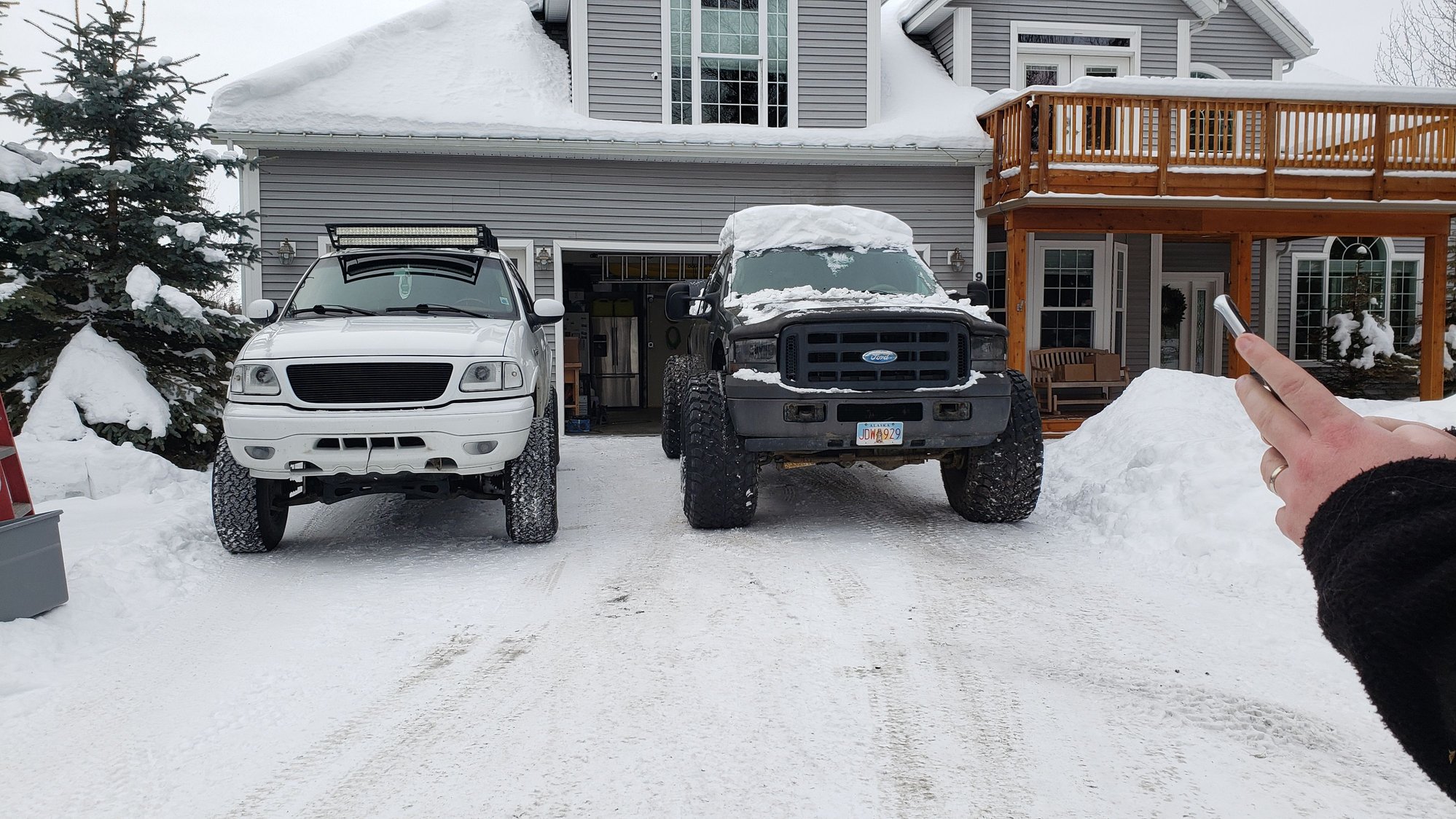

tossed the big tires on to see how she looked.

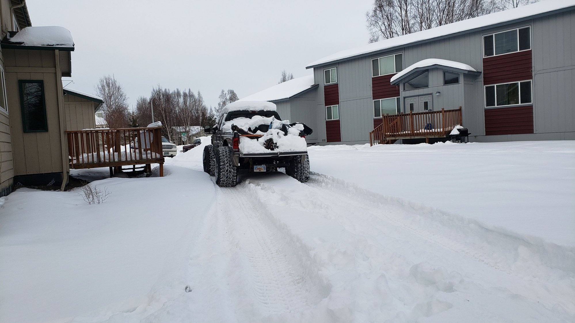

we also decided the truck would be too heavy for the half ton to tow. so we got a 18 350 and a 40.5 goosneck to haul it around.
tows the truck and trailer great!
