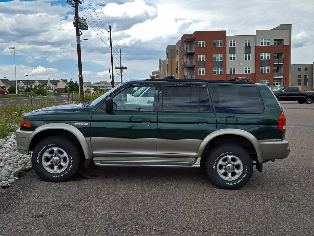

Ok, let's try this one more time ...
I started this conversion a few years ago, then got totally sidetracked.
Another '97 Montero Sport SAS
So, rather than try to resurrect the old thread I figured I'd just start a new one. Especially since a few things have changed in the last three years. :)
I dropped the idea of using my black '97. The entire 3.5L conversion in my SAS'd '97 - while working - has been a huge PITA. I've never been able to get the problem of too much timing provided by the 3.0L ECM resolved and have resorted to using brute force. Huge, insanely expensive radiator with dual Contour fans. That still doesn't fix the detonation issues.
Rather than create another PITA I decided to start with a Sport that already has a 3.5L - the 1999 Limited. It took a while but I finally stumbled across one here in town. Cosmetically its almost perfect. Unfortunately, the POs quite literally drove the drive train into the ground. :( Anyway, after two and a half months at the dealership, here it is ...
The current plan ...
37x12.5x15 Geolandar M/Ts
Dynatrac ProRock44 w/5.13 & ARB air locker; Exploder disks
Dynatrac ProRock44 w/5.13 & ARB air locker; GM 1/2 ton disks
Mitsubishi AW3 A/T swap with Cherokee output adapter housing
NP231J transfer case conversion Tera Low231 w/ NWF crawl box @ 2.72
At least hydraulic assist, but probably full hydro steering
3-Link front w/coil-overs
Alcan leaf springs rear
A lot more of the details are here ...
1999 Montero Sport Limited 3.5L crawler build
The build is already started. First on the list is the transmission swap, t-case and crawl box, ABS delete, ARB compressor for the lockers, air intake, 175 amp alternator and accessory wiring, skids and 2" body lift. Just waiting for a whole lot of parts to show up. :)
Edward
