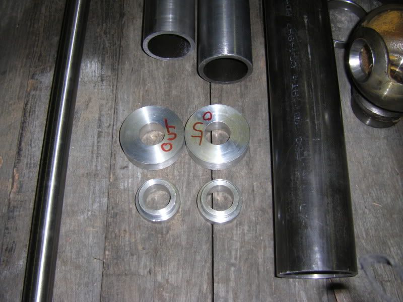

After my stock pile of spare stock birfields ran out i decided it was time to order some longs. I figured i'd do it right the first time and order a set of custom length inners and build a housing to go with them.
The wms to wms will be 59.5", one inch wider then the rear
here is the list of materials i ordered from speedymetals.com
Product Quantity Length Sub Total:
1-1/4" {A} Rd Stressproof (or equivalent) Turned, Ground & Polished
1 72" $58.55
3-1/4" {A} Rd 6061-T6511 Aluminum, Extruded-12"
1 12" $46.77
2-3/4" OD {A} x 2.250" ID {B} x .250" Wall {C} DOM Steel Tube-48"
1 48" $60.55
3-1/4" OD {A} x 2.750" ID {B} x .250" Wall {C} DOM Steel Tube-48"
1 48" $78.83
Subtotal: $244.70
Shipping (UPS Ground): $49.18
Tax: $0.00
Total: $293.88
Then add $200 for machine work which means so far I've got just under $500 into the custom length housing. Still cheaper then all the other fabbed housings out there, maybe not as nice but i can make more for less

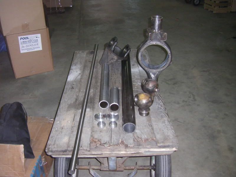

So here is what i am starting with

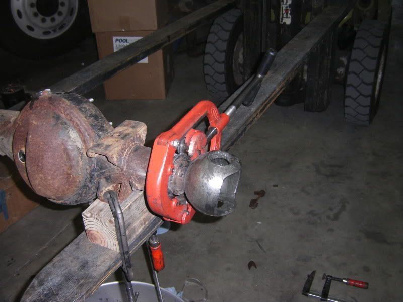

I used a pipe cutter to get the knuckle balls off the old housing
One more
I'll post some more pictures tonight

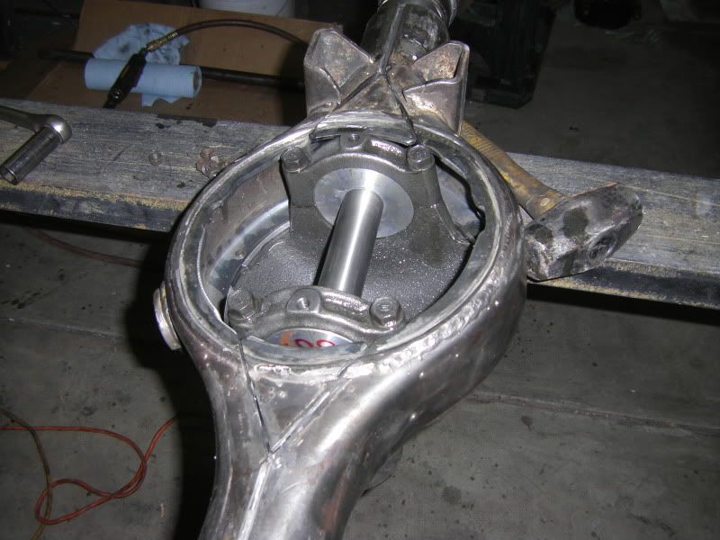

I didn't get a whole lot done today, Mostly just alot of staring, thinking, and measuring
the tubes are in
The new tube was originally 2.75" OD but i had it turned down just enough to fit inside the 3.25" x .250" tube. The inside of the factory housing is still just a little bit smaller, so ground down the factory welds and split the seams a little.
I plan to gusset the tubes inside the housing sort of how the diamonds are.
I havn't decided if i want to sleeve the whole long side with the 3.25" tube yet (way overkill) or just enough to get the knuckle balls on.
