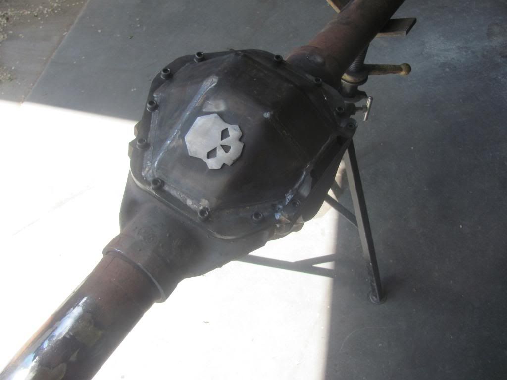

Ballistic 14bolt shave complete.

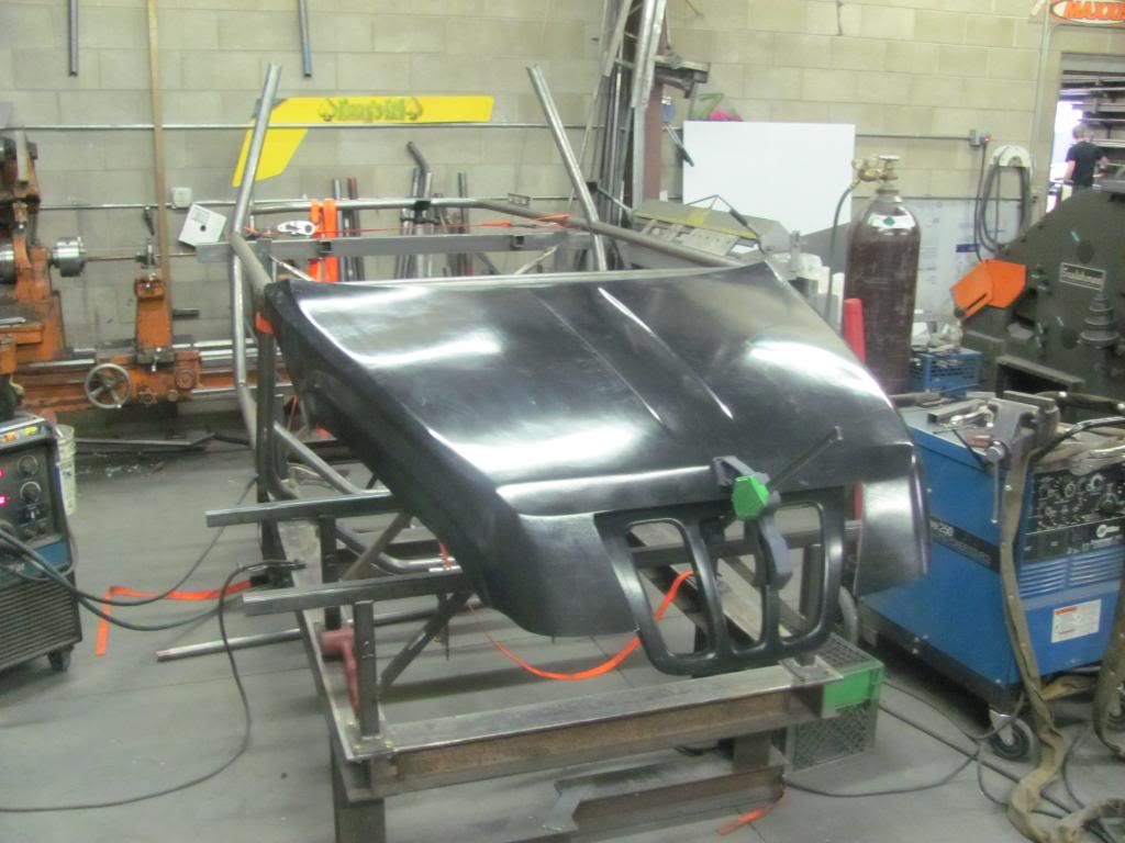

Twisted Customs Grand Cherokee fiberglass hood mocked up.
