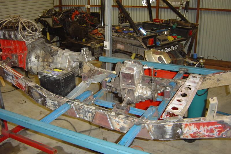

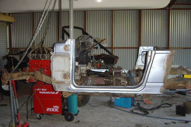

Now was the time for a full rebuild, it had to be lower overall with a higher belly hite, easy to maintain panels easy to steer front and rear and fairly light.
started by notching the body over the rails
fitted up the transfer air shifted
braced up all the belly I feel box section is better than tube here
basic tube work. copyed all the lines from another serria I had at the time

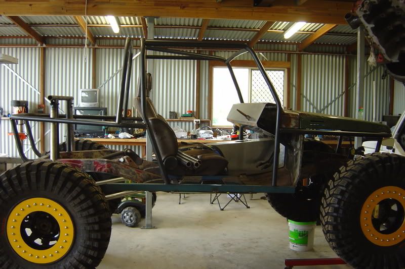

braced up all the frame, trying to keep the suzuki lines
Sorted out the suspension 4 link rear, A frame front
finished all the fiddle stuff and drove it for a few months unpainted with out the rear steer to make sure I was happy with everything

I got a front out put graphted on the rear of the case for rear dissconnect
So I cut all the speedo drive and stuff out and cut up another case for the parts I needed
other than that the other custom bit to make it work was the counter shaft. I got two of them lathed down and turned into one. Here is a stock one next to the custom
It shifted like a dream compared to most disconnects but was a weak link in my drive chain, so I found out when bumping up under cuts. First I used to bust the spigot off the end of the output. so I strengthened it like so
But then I started shattering these little gears
so when I put the rear steer under I decided I didn't need to dig any more so I put a stock housing back in.

while its in the shed for a bit i thought id put a new top on the cage as it was tweaked 3" to one side
gave me a good excuse to test out my new roller bender
put a slight curve to the rear stays and added my own touch with the welder
and streached the rear out by 2" it sits at 99" wheelbase now
