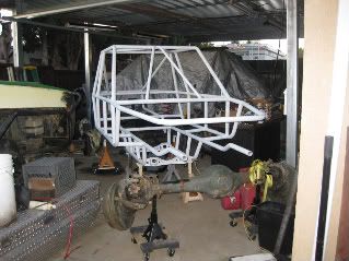

Decided to see how it would look at ride height. good drive shaft angle. Running out of space to work real quickly.

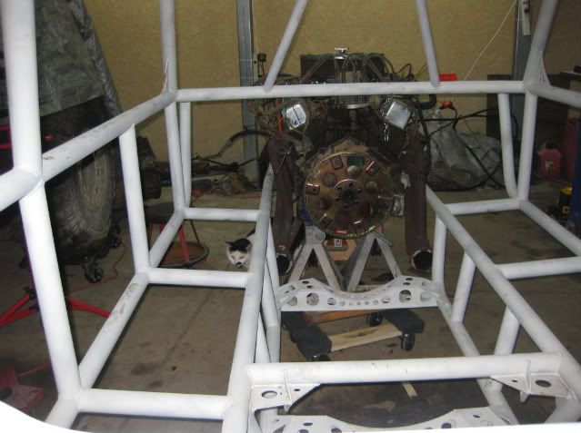

got the engine setup level on jackstands and checked clearance for the exhaust and my current headers do not fit. Got a nice new heavy duty flex plate and new bolts to mount it. Current headers fit the frame rails by about a 1/2 inch but down below are in line with sub frame.
Motor in engine bay. V8 fills it up quick
see how high it sits
made some motor plates this weekend so I can mount it up.

22" clearance under diff!!!!!!! sitting on 38" tires and roller is similiar height to the 42's I plan to run.
I still need some triangulation on the tube holding the chassis up.

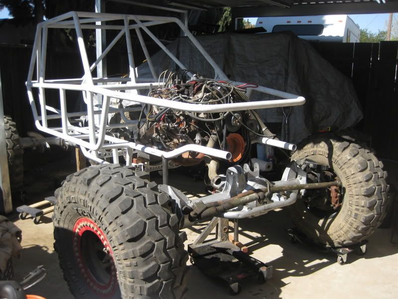

Yeah, i've been slacking on pics. I moved the motor back a good 8" so the distributor is now in the cab. Going wheeling in the snow with the toyota and some tow pig maintenance have been taking time away from the buggy build. Got another snow trip planned so hopefully July will bring some more progress.
Still working on it. Life got in the way and needed to rebuilt the 4 runner motor so I can keep wheeling while building. The 4runner is almost switched over to a 22r on propane. This project is going to make a change as I am selling the mogs and going to go lighter but not sure which axles yet. I picked up some 40" stickies on beadlocks recently for this build though and got an atlas mounted up. I guess I need to add some pics.
Finally got back to working on it. I moved it into the garage (1 car garage) so I will be out of the elements for the winter. I sold the mog 404's as I thought they would be too wide and heavy. I picked up a spidertrax front with ARB and 4.88 gears. 60 outers with 35 spline all the way through. Still had dana u joints though. Also a hi 9 in there.

Here is the rear tack welded as I found I was missing a few parts that I thought I had. This is fully compressed.
uppers are 1.75" x .120 wall DOM and lowers are 2" x .250 wall DOM. Thought I could save some weight with the smaller uppers and since I won't beat them up like the lowers, they would be ok.

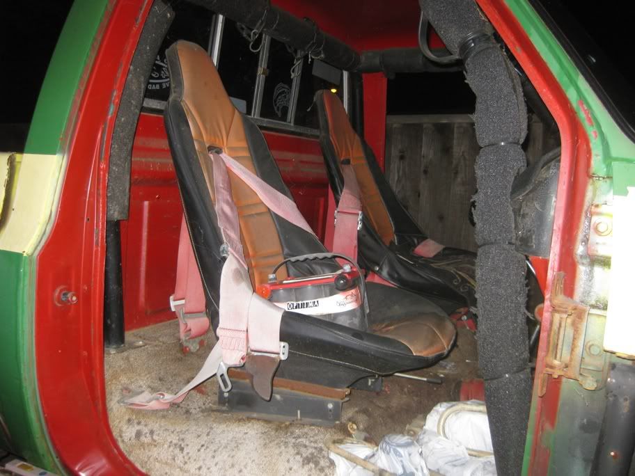

The bucket seats are too big for the back as I am 5'10 and my head is above the roof line and my forehead is too close to the rear bar.
Luckily I did not cut anything yet and I am going to go back and use the rear the way Mike designed it with a 36" bench seat.

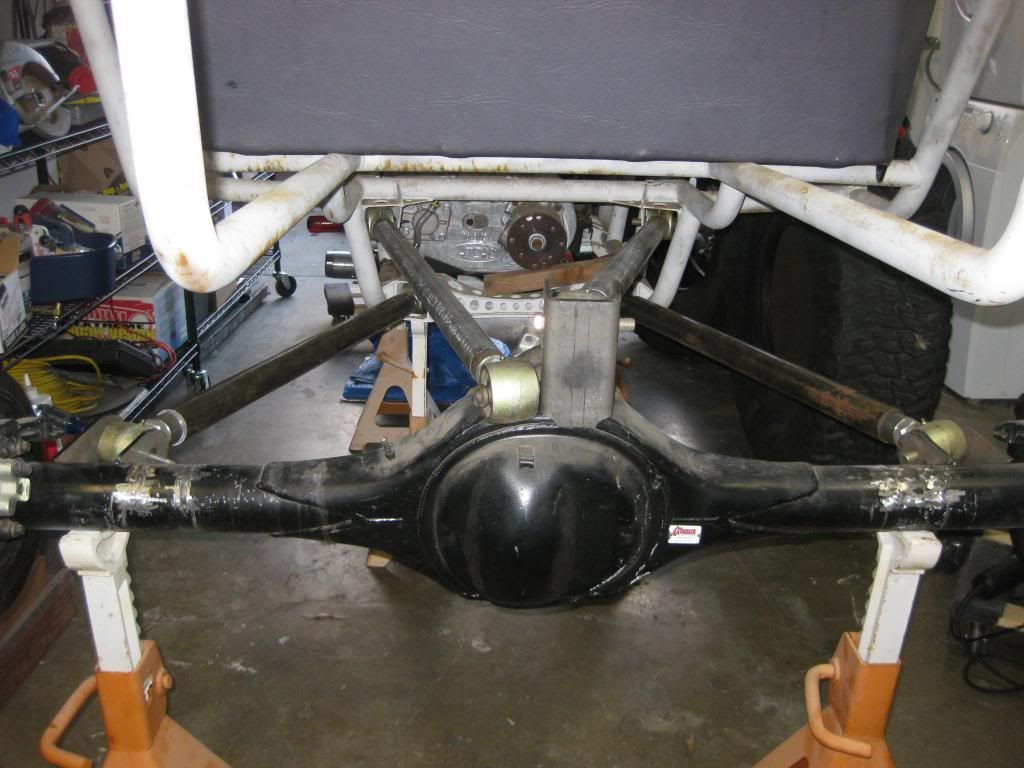

Finally made some progress on the back and got the links set to the right length and mounted the shocks. I was happy the tubes I added for the shock mount follow the lines of the chassis and the rear seat. I like the look of the red ORI's.
The power strip next to the bar is for those looking for a little extra excitement.
