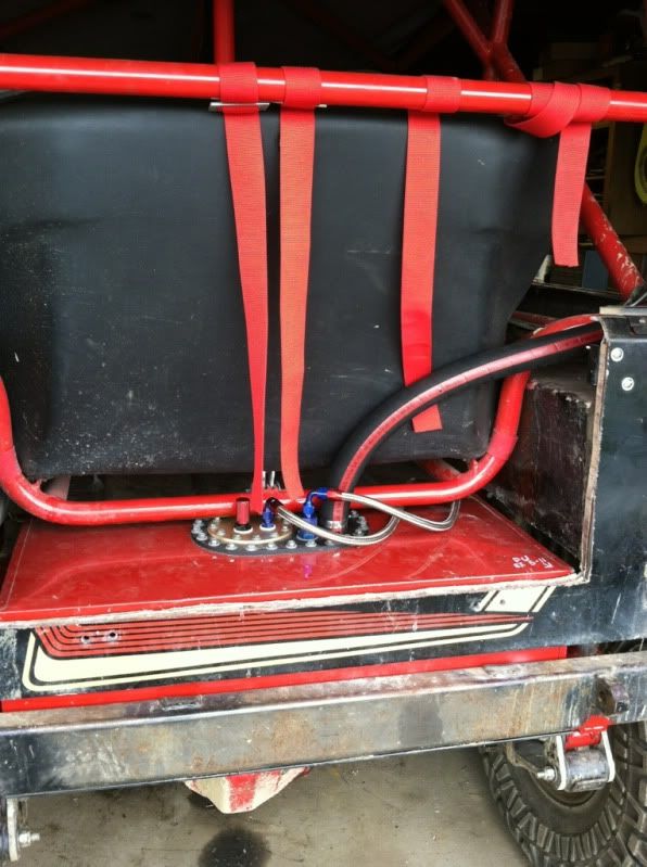

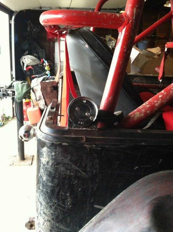

plumbing is done and jeep is running again. I used all -6an and braided stainless hose. Biggest problem i had was finding the right fittings for the feed side of the throttle body and inlet side of the pump. I used a thru hull boat filler neck and marine fuel fill hose. :smokin:
now i need to start the sheetmetal... but piss on it for now, too much work and not enough wheelin, im gonna take it out and beat on it a bit :flipoff2:
