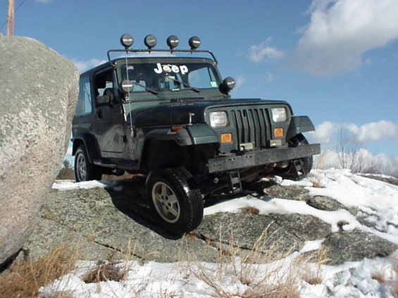

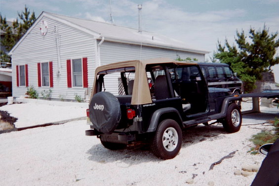

I have had this YJ since 2001. It was bought to replace my 1991 GMC Jimmy that was stolen my first week of college. As with most around here it has undergone quite a few changes over the years as I got more and more into wheeling so I’ll start with the evolution.
When I first got it. Bone stock.

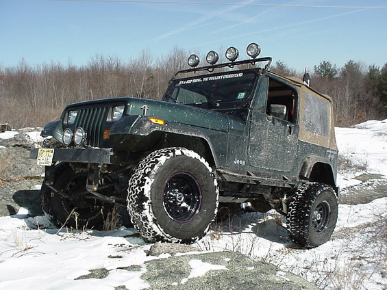

Probably the biggest mistake I made, rough crappy 4” lift kit, 33” all terrains, some home made rock rails, etc
Stepped up to 35” procomp Xterrains

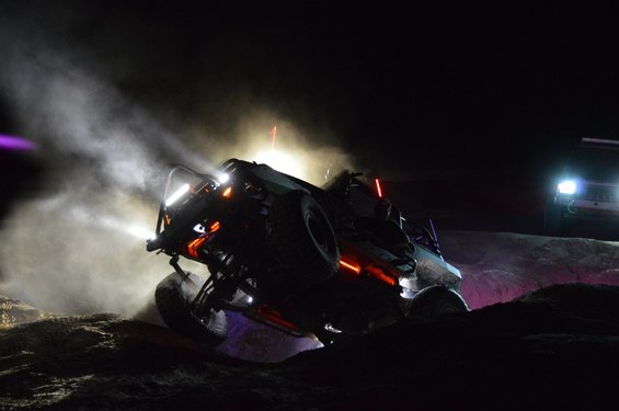

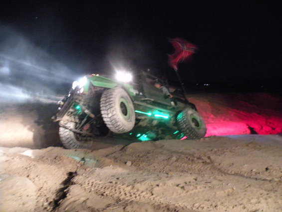

More or less how it currently sits. Swapped to Rubicon Express 4.5” extreme duty springs after having so many issues with the rough country junk over the years, Great Lakes Offroad diy beadlocks, still on 35s. A few armor upgrades over the years, tossed in an 8.8 with an ARB when I blew up the Dana 35, etc.
And the real motivation for doing this rebuild

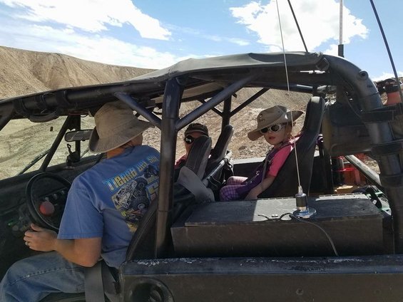

So as you can see above, my little girl is currently strapped into a kids suspension seat sitting on a frame I built to go above my fuel cell. I figure she’s only gonna fit this set up for one more season so I gotta get something done to give her some more space.
