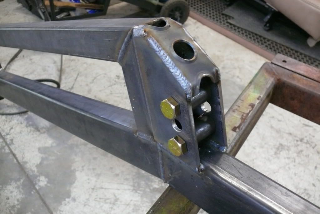

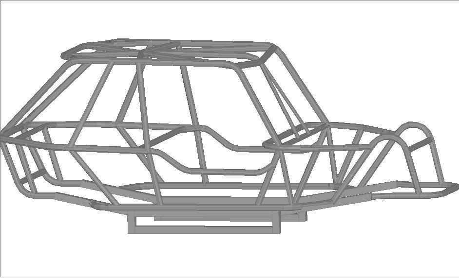

Chassis
This will be a one off chassis that was originally designed for myself but will likely be added to our lineup soon.
It will be a 2 seater with lots of room in the passenger compartment for days of comfort on the trail
and a little extra room for all the gear. It will be 58" wide at the cowl, 20" belly at ride, the rockers will have 30" of clearance at ride, the top of the cage will be around 71" at ride. WB will be 111"

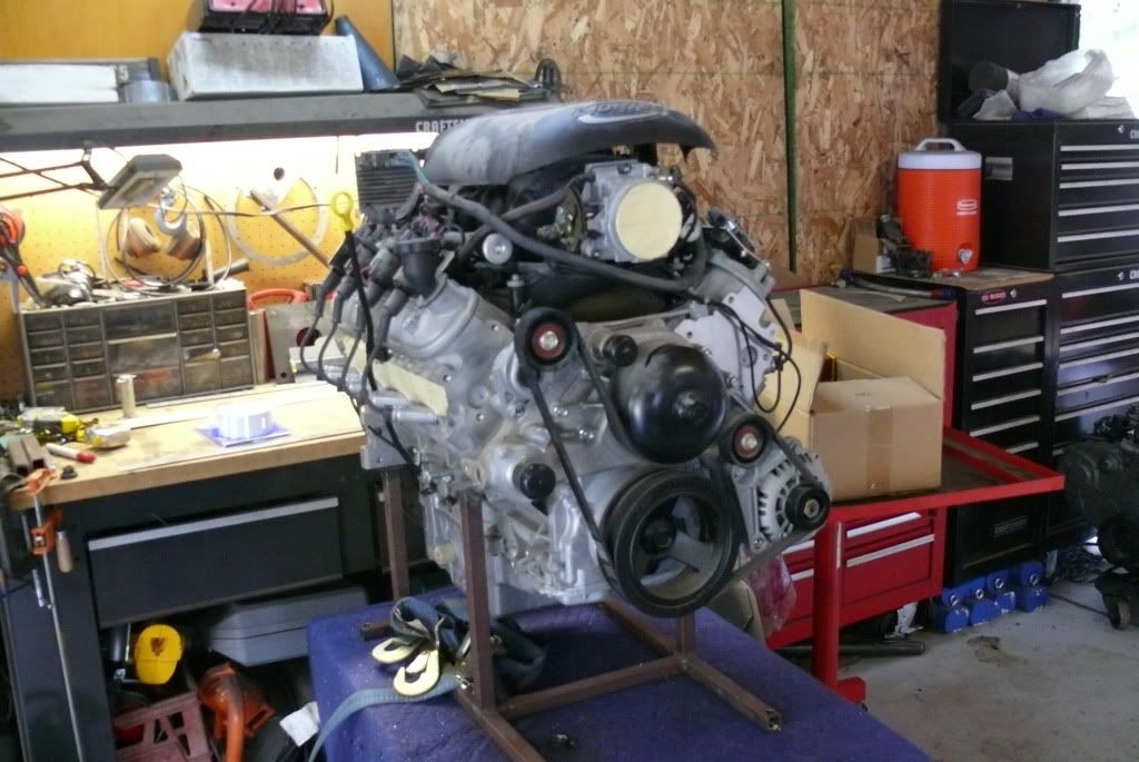

Engine
The engine is from TurnKey Engine Supply. 390hp all aluminum LS1 with the LQ9 intake

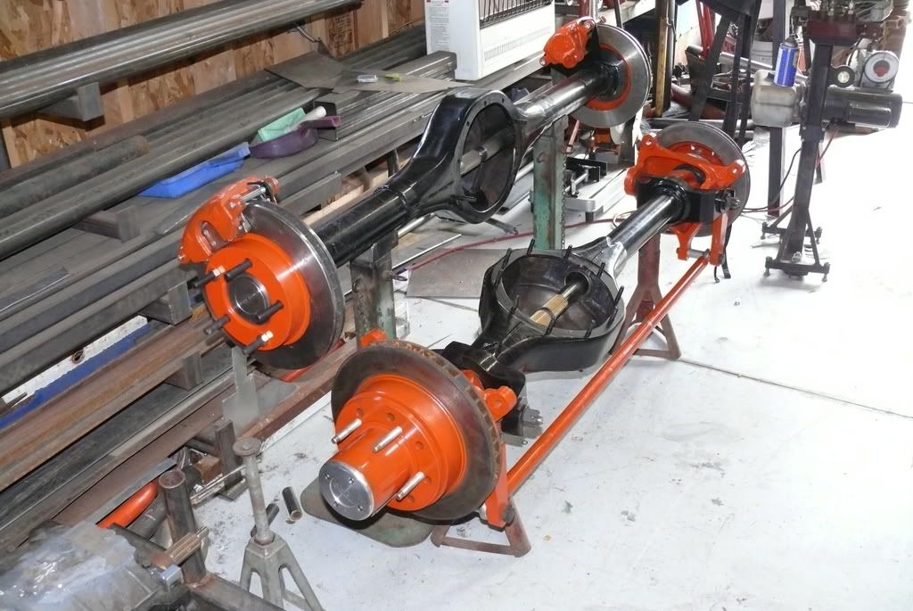

Axles
9" housings narrowed to 62.5"WMS
front has SOLID inners with 1995 Ford F350 outers
the tops of the knuckles have been machined for highsteer arms that line up with the stock Ackerman arms. TERA 35 spline drive flanges. YUKON 4340 35 spline axles (inners, outers, and custom rears... all cut down and resplined for the axles. The front will use stock F350 one ton brakes and the rear is set up with chevy 3/4 ton calipers already. The bottom of both housings have already been shaved for additional clearance, and of course they will get trussed up for strength...

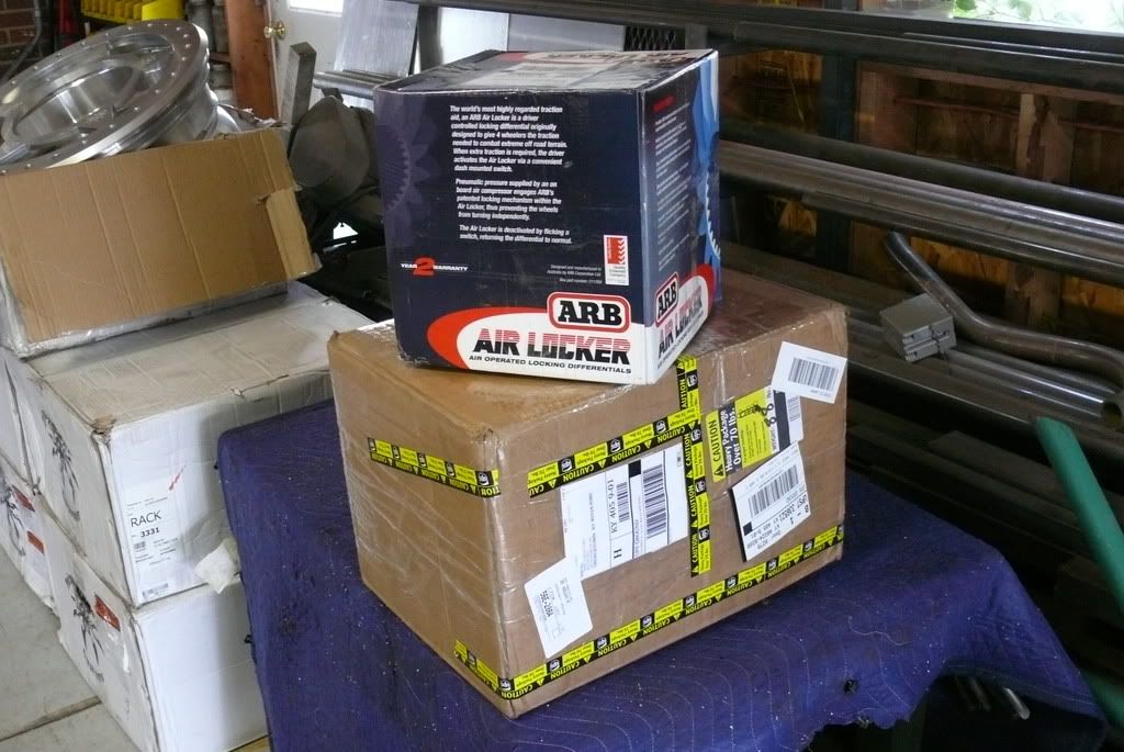

Gearing
Front … due to the amount of up travel we are after I’m not sure a Hi9 will work, so if it doesn’t I talked quite a bit with Mike and Chris at TruHi9 about a backup plan. Turns out I can get a Nascar third with 5.42:1 gears (polished, lightened, and hardened) with a 35spline pinion to match up nicely and still have the strength and reliability we are after. I’ll fit it with an ARB in house. For the Rear, Mike set us up a MEGAHi9 with 5:40 gears and an ARB. We know going into this that the ARB will be our week link in the axles… but keep in mind, This is a dual sport rig, and the owner wants to keep it a long time. He’s not likely to be quite as hard on it as a competitor.

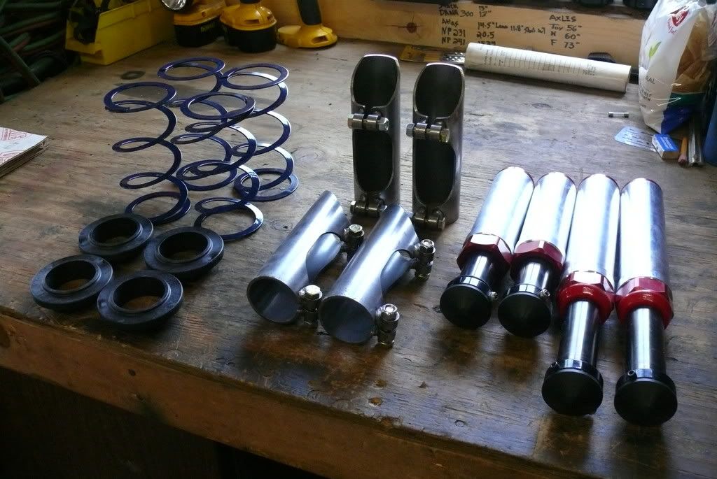

Suspension
A very special thanks goes out to the guys at Polyperformance for working with us on getting the shocks set up to our needs… they in turn are working with Racerunner directly to get us dialed in and set up to perform the way this buggy will demand. I can't say enough how cool these guys are to work with and helpful they have been.. Here is what we have put together…
Front -3 link design with DOM control arms and QA1 heims. Dampening will be controlled by 14” 2.0 Racerunner coilovers, remote reservoirs, triple rate springs, and Racerunner 2.0 bumpstops with 2.5” stroke. Travel will be setup for 45% bump.
Rear -4 link design with DOM control arms and QA1 Heims. The rough stuff will be controlled by 16” 2.0 Racerunner emulsion coilovers set up to be triple rate coil carriers, 2.0 16” Racerunner external bypass shocks will help with dampening along with 2.0 Racerunner 4” bumpstops and a Currie Sway bar should handle anything we throw at it. Travel in the rear will also be 45% bump.
